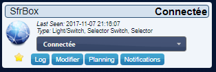

I created 2 devices in domoticz
1) a dummy text

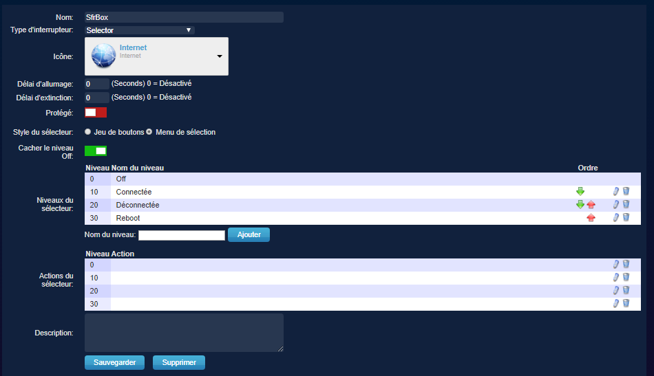

2) a dummy selector switch

	create a dummy Selector switch
		set 10 level Unconnected (or with your own language)
		set 20 level Connected
		set 30 level Reboot

					Selector switch in domoticz
//level 10 for Unconnected : Same as defined in domoticz
$ConstUnconnected="Déconnectée";
//level 20 for Connected : Same as defined in domoticz
$ConstConnected="Connectée";
//selector index
$SelectorSwitchIndex="415";
