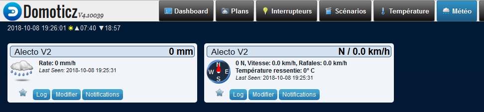

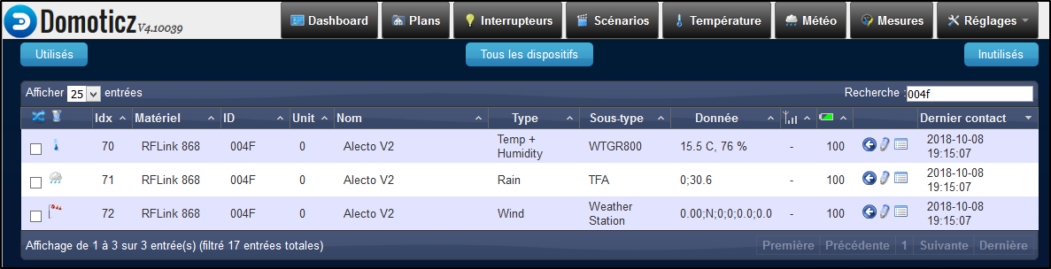

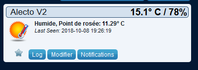

I built a RFLink 868Mhz, and my OTIO WH5100 weather was detected quickly. I think it must be in beta because on a stable Domoticz v3.9700, I did not detect it, but I did not think to go into beta on this Raspberry.
The RFPlayer firmware v1.34 still does not see it.
Résult:
There is no wind tonight ...
