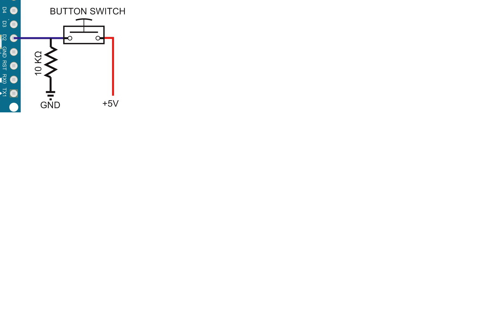

First you need to make hardware connection of doorcontacts to arduino. Prefer digital pins and don't forget to put resistors. You can find info on this on the internet.
Then you have to create Dummy Switch devices in Domoticz, one per doorcontact.
On Arduino i used this .ino (For 24 door contacts and PIR sensors):

just used your code for Arduino, I have edited the file to suit my needs i.e. IP address, ports etc.
I have commented out nearly all the inputs apart from the 1st one
#define PIN_MUTFAK_SU 4
int MUTFAK_SUStatus = UNKNOWN;
int IDX_MUTFAK_SU = 44;
Anything related to MUTFAK_SU I have left in every other device I have commented out.
I created a dummy switch in Domoticz and in SETUP/HARDWARE it has an IDX of 44 however in setup devices
517 MUTFAK_SU 00014255 1 MUTFAK_SU Light/Switch Switch Off
I have swapped between 517 and 44 no difference.
I have wired the switch as per the diagram attached but to pin 4
if I run serial monitor I can see the switch turning on and off although it switches on/off /on/off when switched
but I still see nothing in Domoticz nothing in the log, although my Domoticz does require a password i'm not even getting a failed to connect or similar.
Any ideas will be greatly appreciated as this is exactly what I am looking for.
I have a hardwired alarm system and can use the existing devices to control scenes.
cheers

the IDX you should be using in the .ino is in the Setup/Devices Page. So, you should use 517, not 44... In case there might be some typo or something i post you here the 1 input code. Please use this .ino:

alarm_guy1
- Posts: 132
- Joined: Tuesday 14 January 2014 0:03
Re: Opinions on Arduino based cable connection
this is how my contact is wired too
- contact.jpg (88.58 KiB) Viewed 4877 times
