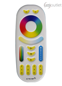

This remote works with R47, excellent. Log pressing OFF and ON says :Stuntteam wrote: Tuesday 03 October 2017 13:18 RFLink should work with all types of remotes or at least most of them.
We have one set under investigation however, this is most likely an unofficial clone.
2017-10-05 14:49:47.409 RFLink: 20;14;MiLightv1;ID=200C68;SWITCH=00;RGBW=0000;CMD=OFF;
2017-10-05 14:49:47.426 (RFlink Original RPi Boven) Lighting Limitless/Applamp (MiLightv1)
2017-10-05 14:49:47.682 RFLink: 20;15;MiLightv1;ID=200C58;SWITCH=00;RGBW=0000;CMD=OFF;
2017-10-05 14:49:47.693 (RFlink Original RPi Boven) Lighting Limitless/Applamp (MiLightv1)
2017-10-05 14:49:54.034 RFLink: 20;16;MiLightv1;ID=200C58;SWITCH=00;RGBW=0000;CMD=ON;
2017-10-05 14:49:54.045 (RFlink Original RPi Boven) Lighting Limitless/Applamp (MiLightv1)
2017-10-05 14:49:54.254 RFLink: 20;17;MiLightv1;ID=200C58;SWITCH=00;RGBW=0000;CMD=ON;
2017-10-05 14:49:54.265 (RFlink Original RPi Boven) Lighting Limitless/Applamp (MiLightv1)Re: RFLink R47 available
My pleasure!!!!
