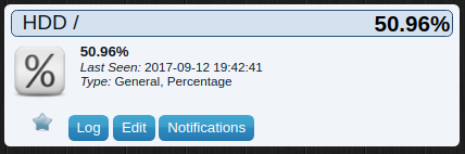

I'm using Motherboard sensors to monitor my Raspberry Pi 3. I run my RPi from USB-connected 32GB SSD.
df -h gives:
Filesystem Size Used Avail Use% Mounted on
/dev/root 30G 2.5G 26G 9% /
But in domoticz it says that HDD / is 50.96% full
So the sensor is not working
Any idea how to fix this?

It appears that / and /boot are switched
/ shows free space for /boot
And /boot shows free space for /
devtmpfs        460M     0  460M   0% /dev
tmpfs           464M     0  464M   0% /dev/shm
tmpfs           464M   12M  452M   3% /run
tmpfs           5.0M  4.0K  5.0M   1% /run/lock
tmpfs           464M     0  464M   0% /sys/fs/cgroup
/dev/sda1        42M   21M   21M  51% /boot
tmpfs            93M     0   93M   0% /run/user/1000
