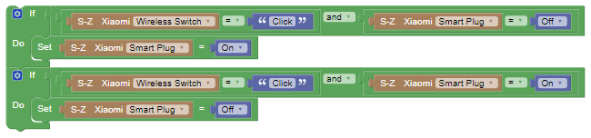

Thought I would post here rather than create a new thread.
Brand new to Domoticz and I have tried doing a similar thing.
If I use the same Blocky as the original post, the LED on the Gateway continually flicks on and off.
If I try apinyot solution, it does nothing at all.
If I try theo solution (LUA) it also does nothing.
The below works, but there is no way to turn off/toggle the light
Anyone have any suggestions as to where the issue may be?
