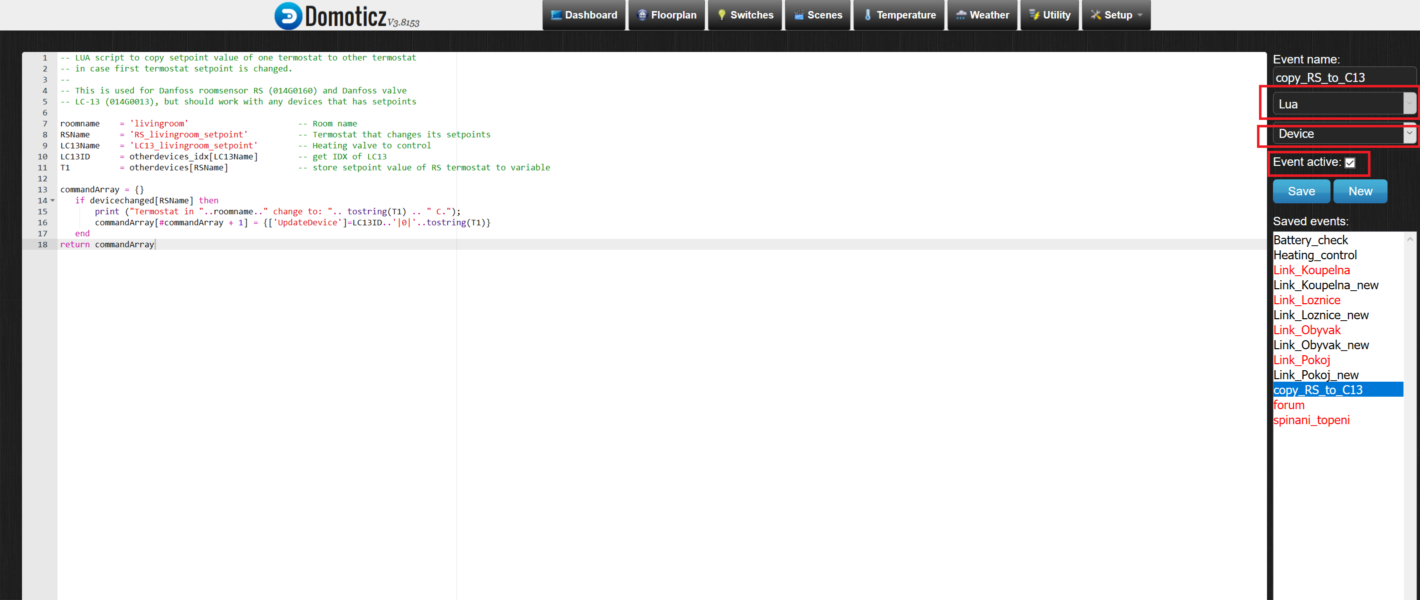

-- LUA script to copy setpoint value of one termostat to other termostat
-- in case first termostat setpoint is changed.
-- This is used for Danfoss roomsensor RS (014G0160) and Danfoss valve
-- LC-13 (014G0013), but should work with any devices that has setpoints
roomname    = 'livingroom'                      -- Room name
RSName      = 'RS_livingroom_setpoint'          -- Termostat that changes its setpoints
LC13Name    = 'LC13_livingroom_setpoint'        -- Heating valve to control
LC13ID      = otherdevices_idx[LC13Name]        -- get IDX of LC13
T1          = otherdevices[RSName]              -- store setpoint value of RS termostat to variable
   if devicechanged[RSName] then
       print ("Termostat in "..roomname.." change to: ".. tostring(T1) .. " C.");
       commandArray[#commandArray + 1] = {['UpdateDevice']=LC13ID..'|0|'..tostring(T1)}
return commandArray
Go to your domotiz WEB GUI menu Setup >> More Options >> Events. Change the script to LUA on the right side of the screen (see attached picture). Then copy paste this code and change the RSName and LC13Name variables to names that you gave to your heating setpoint of RS and setpoint of LC13.
Do not forget to check the tick to activate the script and save it. After saving it should be active and react on change of RS setpoint change. Once you change it with buttons on RS you should see a message in your Domoticz log (in web gui go to Setup >> Log). Message should be something like "Termostat in livingroom change to: 23 C.".
Change of LC13 setpoint is not immediate. It needs to wake up to get the new value. Based on you wake up period the change could take quite some time. If you have the period set to 300 s then it should take max 300 seconds for LC13 to get new value.
(image https://imgur.com/a/YpXZ8)
