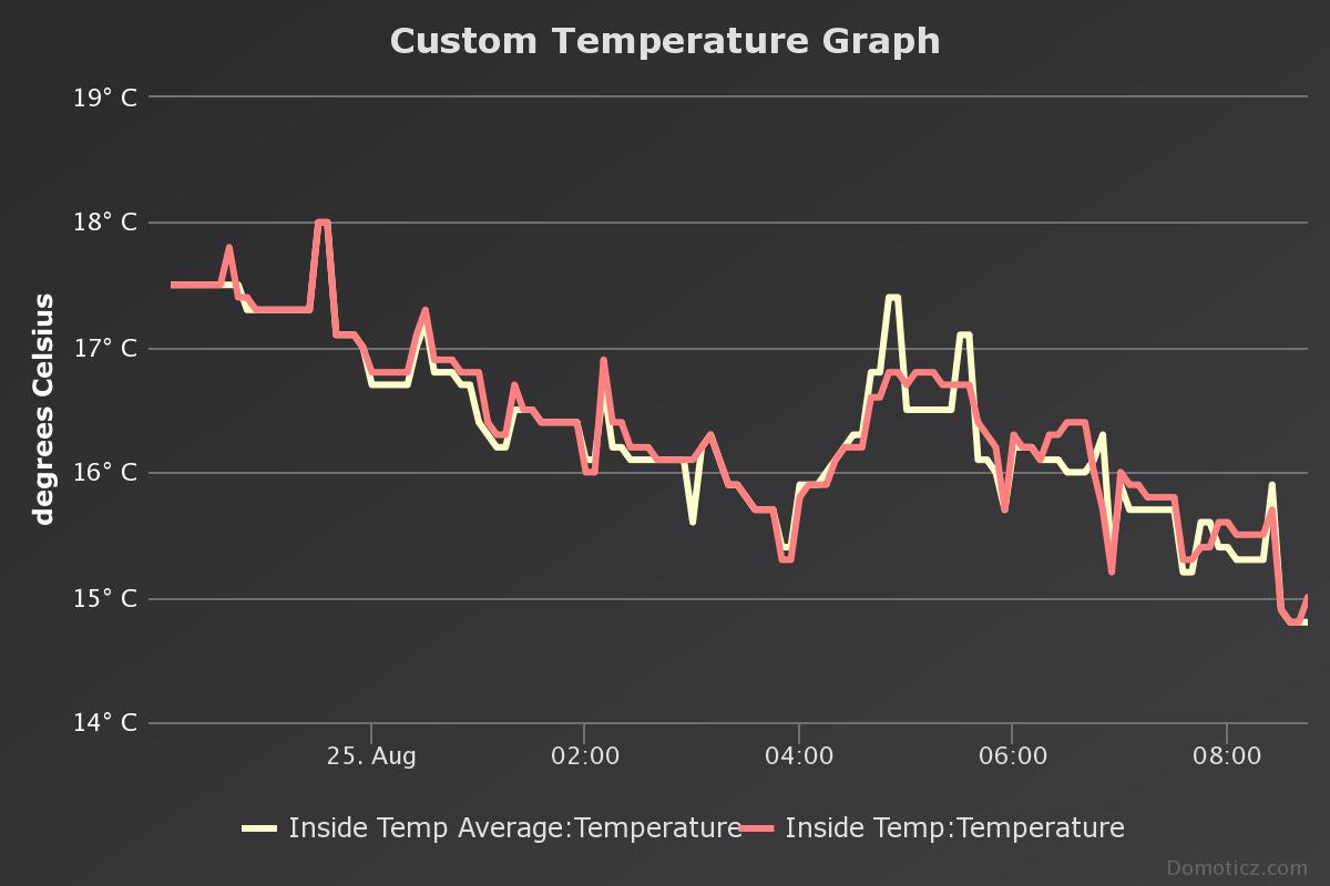

Thanks for the help so far, I made up a script based loosely on DewGew's Code, it only uses data at the instant it is run, and excludes and sensors that have stale data (older than 30 mins), this is then used to create an average that is sent to my dummy sensor. I found that pooling every hour was a little unreliable, and even at 30min I found I would still like more data points.
So I ended up having it activated by the input sensors again, as they still poll less than running it every 5-10 minutes, and I am grabbing a new data point when ever a input is updated.
I did have 1 instance where my sensor zeroed, so I added a IF to filter out when Temp and Humidity = 0.
Considering this approach should eliminate the double data points I was seeing from some points, the end result is VERY similar to my original, maybe even a little more spiky, I'll run both for a bit long to see how they compare. I have reduced my original script it only keep 2 hours data instead of 12, file is 4.5k now.
Yellow = New Script, Pink(ish) = Original
chart (1).jpeg (59.08 KiB) Viewed 5636 times

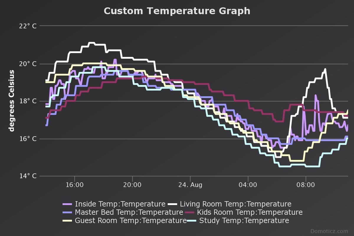

Ran both sensors for a few days, results are very close, both have some unexpected peaks, but I have decided to stick with a modified version of DewGew's script.
Rather than using multiple if statements, is there a way to use a foreach to do each sensor in the variable?
