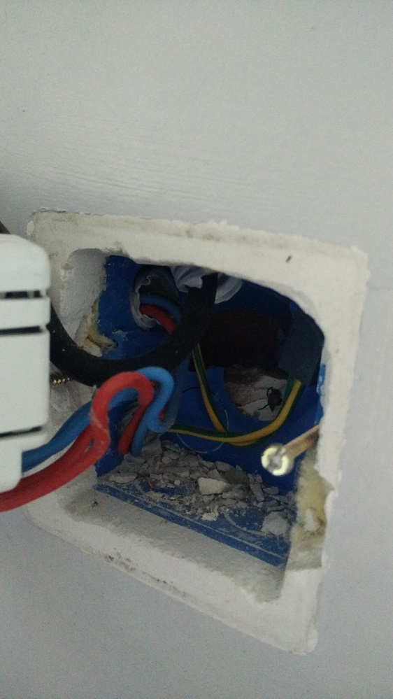

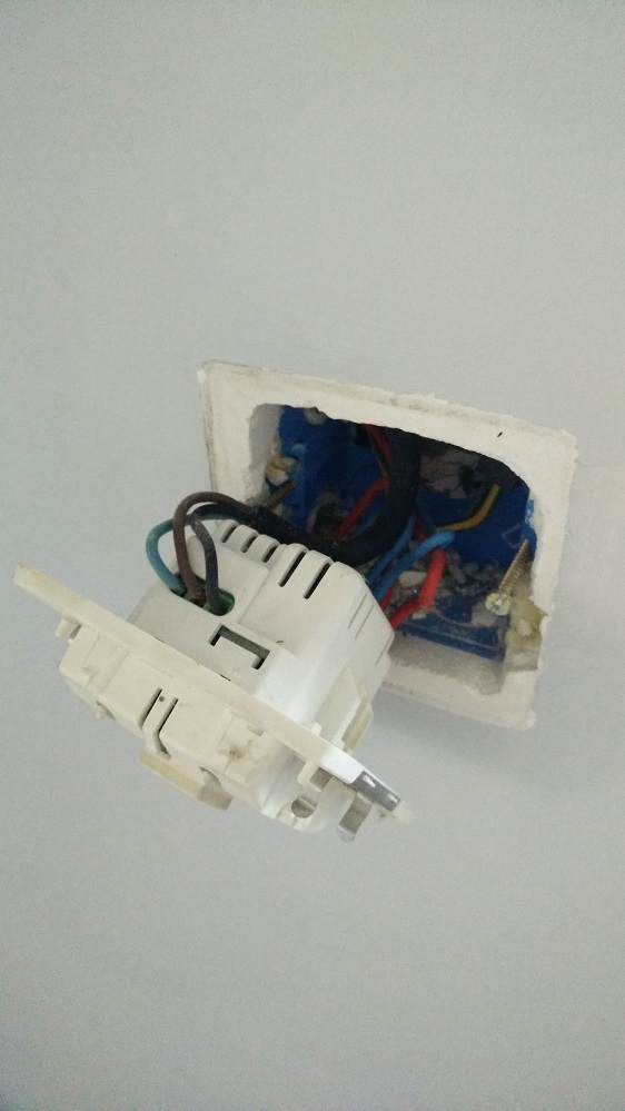

I want add Fibaro Roller shutter to my store but i don't understant why I've 3 electric sheath (cf attachements).
I don't know how i can connect my store and the module with this configuration.
1 sheath (on top) with 3 cables (black, brown and blue)
1 sheath (on top) with 3 cables (blue, red and ground)
1 sheath (on bottom) with 3 cables (blue, red and ground)
I think the "on top" sheaths are the blind sheaths (alim and motor) and the bottom sheath is the general alim
In the general configuration we have just 2 sheath: the general alim and the store sheath with 4 cables (black, brown, blue and ground)
Somebody can help me ?
Fibaro Roller shutter 2 and Bubendorff blinds

I am not an electrician, but to me it looks like the three cables are going to your shutter motor. Red and blue are(as far as I know) phase and null.
There is probably another wallsocket or switch attached to the red and blue wires.
detach them and measure.
Succes, Hans
Succes, Hans

Indeed !
I'll check if the alim go or arrive to or from another switch or wallsocket
Thanks !
Thanks !
