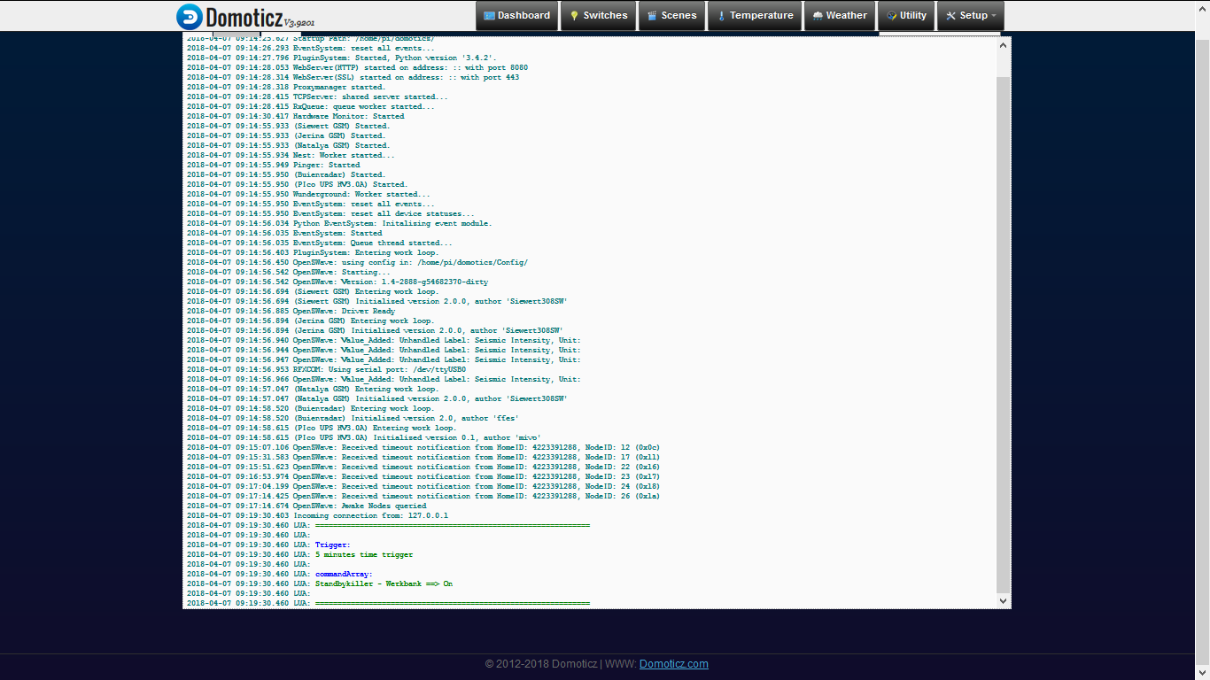

Did moving the RPi3 help? Can you give an update on this? I am still seeing this issue.
Have tried a lot, moving RPI and extending the USB cable to be able to move the Aeotec further away from any possible noise causing device and such but nothing helps.
I don't have timeouts during the day.
But only when i reboot the Pi i see timeouts when the Aeotec is initialized.
Nodes then have a timeout are powerplugs as well as battery powered devices.
Then i also see for all z-wave devices double entries like:
2018-04-07 09:27:16.720 (Aeotec Gen5) Lux (Gang - Lux)
2018-04-07 09:27:16.801 (Aeotec Gen5) Lux (Gang - Lux)
2018-04-07 09:27:16.814 (Aeotec Gen5) Lux (Gang - Lux)
This continues sometimes for 1 minutes and sometimes for 1 hour.
I tried to reset en setup all nodes several times as well as starting from scratch with Domoticz and such but this doesn't help.
Something aint right with the z-wave.
Issue seems to be resolved when all nodes awake queried.
Don't know what is happening in the background but looks like it stabilizes after a while.
Still it's annoying and rebooting the PI does trigger all Lua scripts as all z-wave devices are triggered like i mentioned above which is causing a high mem/cpu load.
My mesh looks stable.
All nodes do communicate directly to the controller and have routes via other nodes.

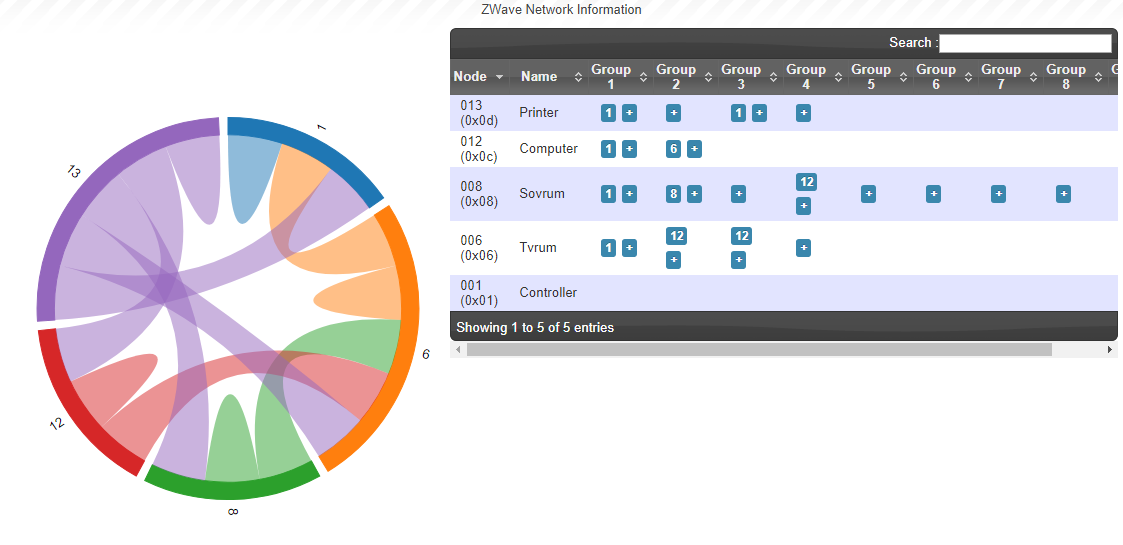

Side note: i do see after a reboot the mesh is empty and only shows the mesh as attached below after all nodes are quired.
Schermafdruk 2018-04-07 09.37.20.png (201.48 KiB) Viewed 11196 times
Schermafdruk 2018-04-07 09.24.09.png (112.24 KiB) Viewed 11196 times

Siewert308SW wrote: Saturday 07 April 2018 9:40 I don't have timeouts during the day.
Try to look at this setup, leading to a problem I had at the very beginning with Domoticz. In my case, not true com problems but linked to my setup at the time: I only had devices I triggered (heater control) & still none reporting statues/measures, with a z-wave network unstable because of long inactivity & a Domoticz default TMO:
http://www.domoticz.com/forum/viewtopic ... ut#p113930
