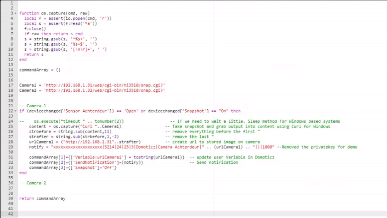

Thank you for the script, but i want to see the screeshot immidiatly, so i solved it like this.
(i'm no LUA expert, so did some copy/paste from other scripts) I do need to clean it up a bit ;)
Basicly i did...
execute the URL with Curl for windows and store the result in "content"
modify "content" so only the path to the jpg is in a variable
added that path variable to the jpg after the camera's IP adress
create a notify variable for PushSafer with the complete location of the jpg
Update the uservariable in Domoticz
Send the notification
Works like a charm :D
