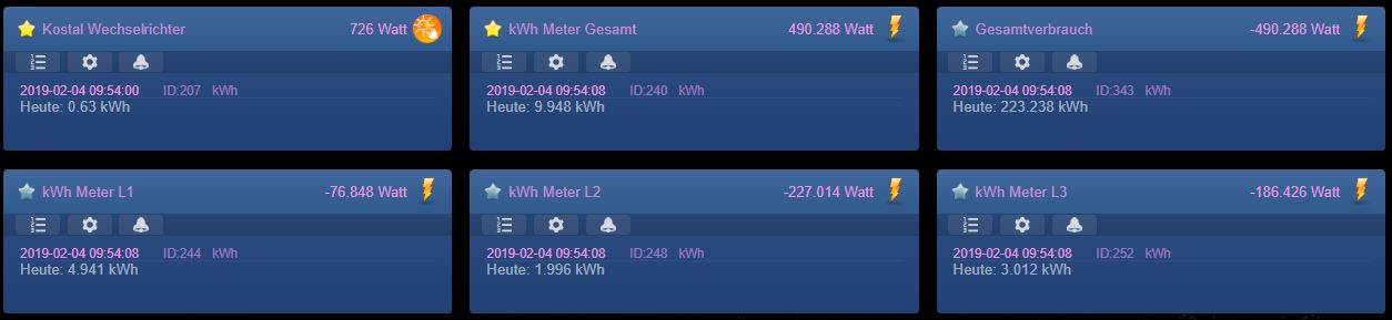

I used this script
-- /home/pi/domoticz/scripts/lua/script_device_calculate_consumption.lua
-- Domoticz IDX and names of the needed devices
local DeviceName1 = "kWh Meter L1"
local DeviceName2 = "kWh Meter L2"
local DeviceName3 = "kWh Meter L3"

to sum energy and power from 3 meters (kWh Meter L1, kWh Meter L2 and kWh Meter L3), because my device for the whole powerconsumtion (kWh Meter Gesamt) shows only the sum of absolute Power [W].
But for this issue I have already opened a thread, https://www.domoticz.com/forum/viewtopi ... 24&t=26760 >>> no answer so far.
The script works, but the energy shows the whole energy consumption instead of energyconsumtion of the day.
What could I do, to get the daily energy consumption?

I don´t know but maybe this could help:
The device for the whole powerconsumtion (kWh Meter Gesamt):

The dummydevice Gesamtverbrauch. Here we can see that the "CounterToday" is the same as "Date":

The device for power and energyconsumption from kWh Meter L1, the same as L2 and L3:

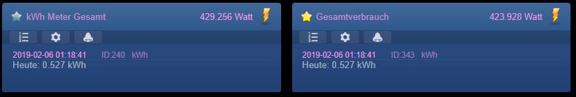

Hopefully this could help someone.

Ok, it´s solved :roll:
The one who could wait has a clear advantage ;)
