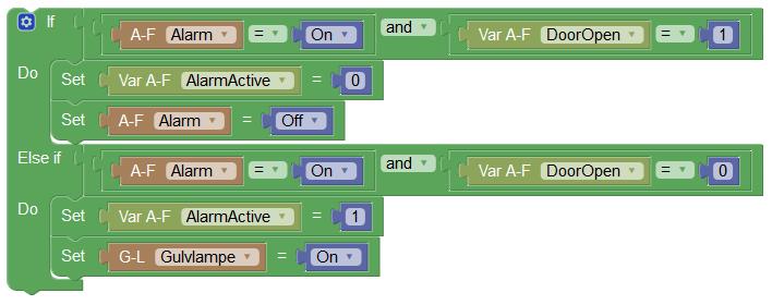

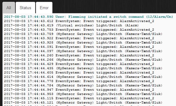

Description: One switch causing Blockly script to loop

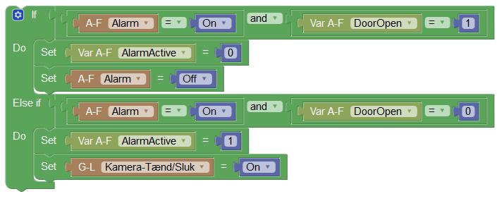

I have this strange issue, where one of my Blockly scripts go into a loop. But it is only one particular switch that causes the problem. For trouble shooting purposes, I tested with another switch, and that switch does not cause the loop. Activating each individual switch works fine.
The problem started after a major upgrade a few days ago, now using Mysensor 2.1.1 and Domoticz v3.8153.
This Blockly causes the loop:
Log:
This Blockly is OK:
Any idea what could be causing this?

I have played around a lot, and made a lot of changes. The solution was to implement a delay of 1 second.
In the end, the Blockly turned out differently, but it works now.
