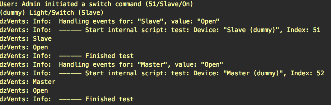

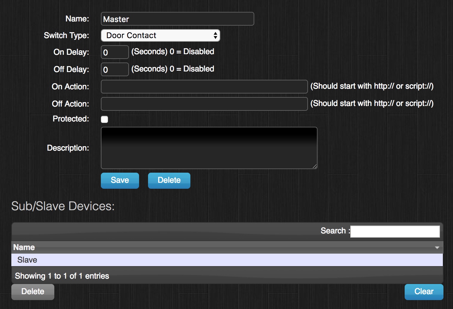

Ok, we have been looking at the code and it turns out that it is quite confusing:
So, let's change it a bit. Create two switches, one called Master and the other called Slave. Edit Master and add Slave there as the sub-device.
From now on, when you switch the Slave, Master follows. If you have an event script for Master and one for Slave, both scripts will be triggered and their state will be correct.
So, you start with this:
Screen Shot 2017-08-04 at 13.12.01.png (106.52 KiB) Viewed 5250 times
Screen Shot 2017-08-04 at 13.31.30.jpg (217.61 KiB) Viewed 5250 times
		devices = {
	        'Master',
	        'Slave'
	    print(device.name, device.state)

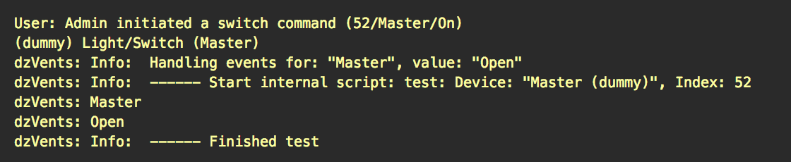

Then I press Master:
Screen Shot 2017-08-04 at 13.13.42.png (51.03 KiB) Viewed 5250 times
Screen Shot 2017-08-04 at 13.14.06.png (103.13 KiB) Viewed 5250 times
And as you can see, the slave isn't affected. And only the Master script is triggered.
Now, at this stage, Master == Open and Slave == Closed.
Now, when I press the Slave:
Screen Shot 2017-08-04 at 13.16.54.png (79.84 KiB) Viewed 5250 times

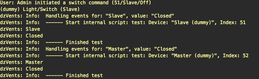

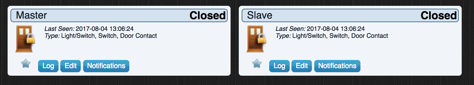

This time, both Master and Slave scripts are triggered with the correct state (both Open) and when I press the Slave again:
Screen Shot 2017-08-04 at 13.18.19.png (79.97 KiB) Viewed 5250 times
Again both scripts are called now both are Closed.
