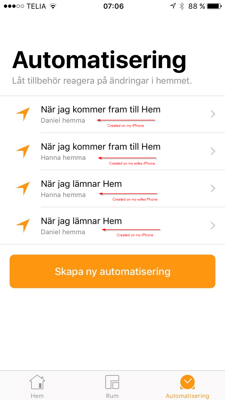

Hi anasazi, tried that too but failed. One question; Do you create automations in homekit per device? What i mean is you create your own automation in your phone and your lets say your wife is creating her automation in her phone? Tried to do that but mixed up all automations since they carry all the same names.

Yes, I do.febalci wrote:Hi anasazi, tried that too but failed. One question; Do you create automations in homekit per device? What i mean is you create your own automation in your phone and your lets say your wife is creating her automation in her phone? Tried to do that but mixed up all automations since they carry all the same names.
When Family Sharing is enabled all my devices from Domiticz automatically shows up in my wifes iPhone when she opens it.
Then I create the rules based on my wifes location on her iPhone and the rules for my location on my iPhone.
I think I had the same problem as you that the Home app named these the same but that changed some time ago when updating iOS to a newer version.
See the attached image.
These rules will then turn on a switch in Domiticz, one switch for my wifes iPhone and another switch for mine.
Then I have a Luascript that will trigger when these devices changes.
For remote access i use Apple TV 4 with Homekit enabled.
