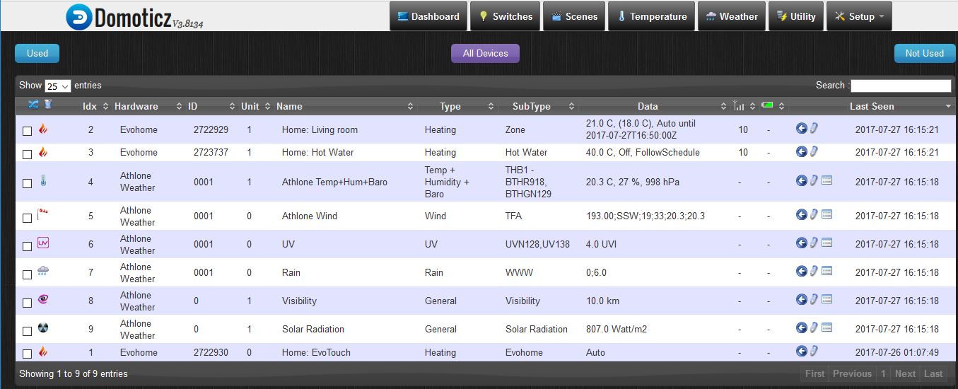

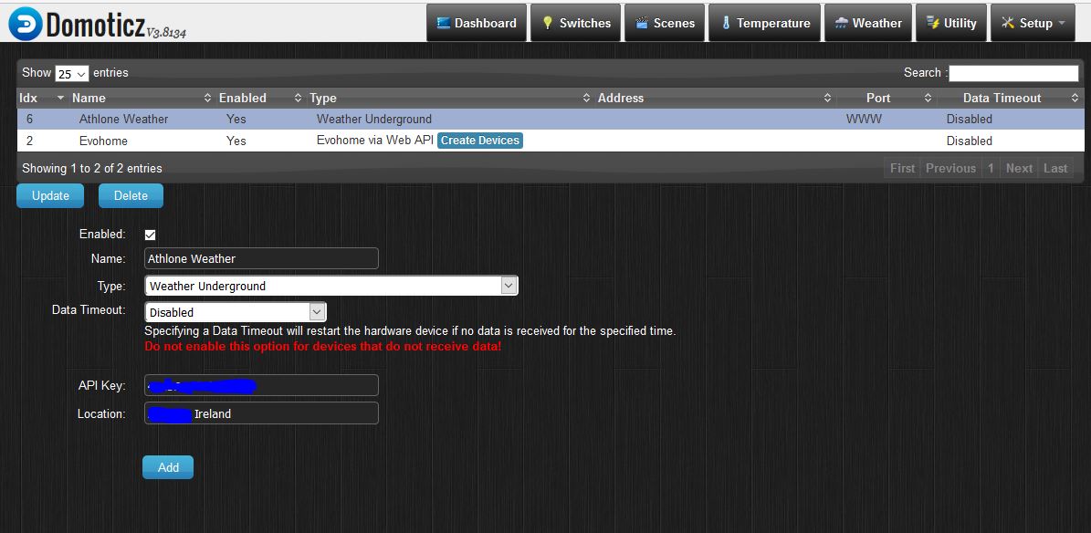

My Settings are show below: I do not know how are the API calls made?
Is one API call for all sensor of the weather station or each sensor gets API call?
