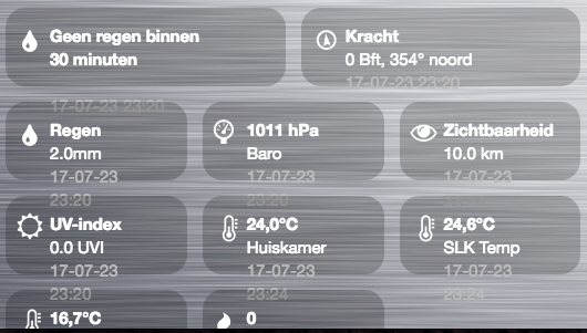

Post by EdwinK »
Although using the settings to not show last update, it still does show them.
The (?) buttons don't give anything at all.

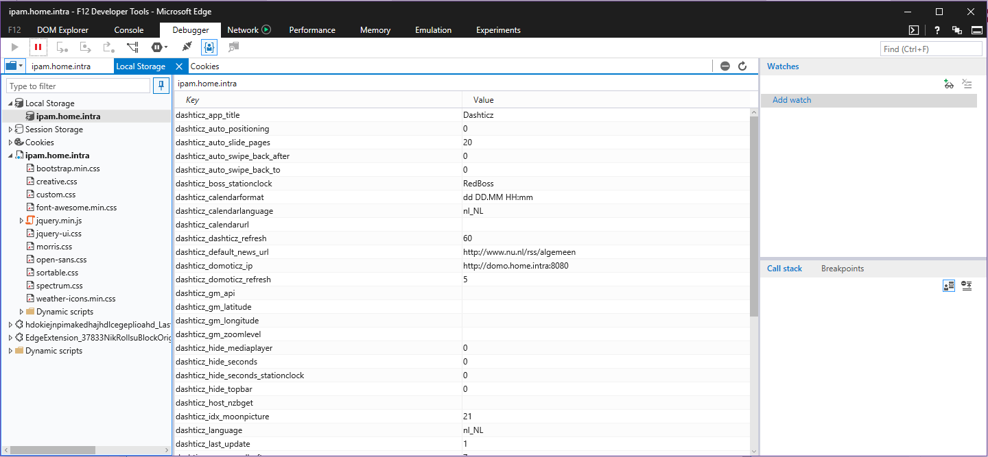

Mozart
Posts: 39
Joined: Monday 19 January 2015 14:35
Re: Dashticz - [BETA]Module - Settings - VERSION 2
Post by Mozart »
I just updated with the latest beta code. After entering my settings in the settings wizard I get the popup with the stuff that I could put in CONFIG.js but I'm not able to select the code and copy it :( I'm using Microsoft Edge by the way.

If I use the F12 in Edge I can see that the page loaded, switching to the 'Debugger' tab shows under 'Local Storage' the settings that I want.
