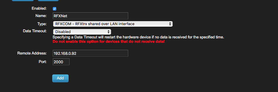

I created the new device as RFXCOM - RFXtrx shared over LAN interface, put in the correct IP and port (192.168.0.92, 2000), programmed the module with TCP+SERVER, Local Port:2000, Baud: 38400, 8 data bit, 1 stop bit, no parity and set the pack len to 8.
I tried adding a device via the usb (so using the old RFXCom setting now 16) to make sure I hadn't broken the RFXtx - and it worked fine.
Screen Shot 2017-09-08 at 11.36.07.png (42.71 KiB) Viewed 13455 times
I'm getting these errors in the log:
Screen Shot 2017-09-08 at 11.41.40.png (23.59 KiB) Viewed 13455 times
though the device respond to ping.
So maybe I'm using the wrong hardware type? or maybe I have a problem with the port - but it isn't clear how to fix.

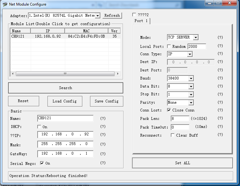

UPDATE -
I've managed to connect by switching to DHCP (strange but true) - not a big deal, I can sort out the address at the router assigning an IP address to a MAC address. Seems like it works!!
I've noted that the RX from the RFXcom goes to the TX on the module (and the same for TX/RX) :)

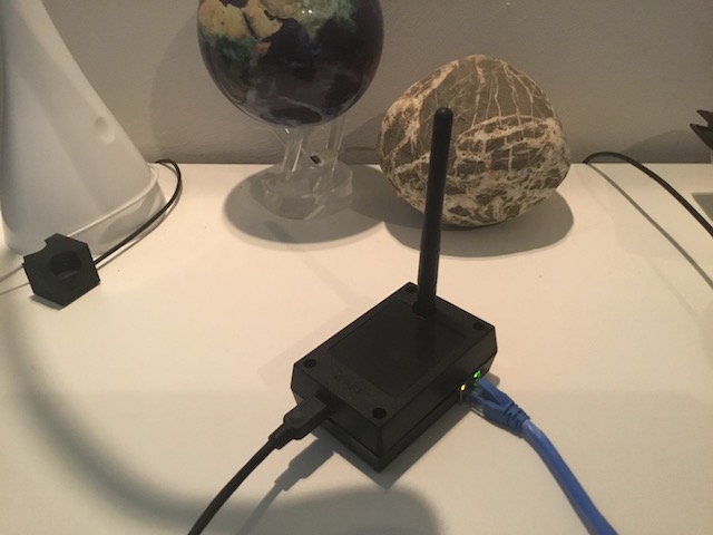

]Final unit.
Thanks for your work - really useful!
For others - here's the configuration file(s) (windows-based)
NetModuleConfig.zip
(60 KiB) Downloaded 418 times
SocketTest3.zip
(98.49 KiB) Downloaded 276 times

nigels0
Posts: 221
Joined: Thursday 23 January 2014 12:43
Domoticz version: 3.8153
Re: Adding lan interface to RfxTrx433
Post by nigels0 »
Ha, it wasn't a 3D print - it was just a hobby box I had lying around which I attacked with a dremmel :)
