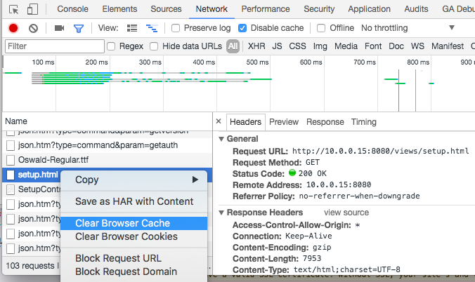

Ok, I do think it is a cache issue. Clearing the cache doesn't always work as expected. What does work for me (in Chrome that is) is this:
Open the console (F12 on Windows, alt-cmd-j on Mac, or any other way that works). Select the network tab in the dev panel and then go to the settings page in Domoticz (or reload the page if it was already there). Then in the list you should see setup.html and SetupController.js. Right click on each of those and select Clear Browser Cache. Then reload the page. Always worked for me.
- Screen Shot 2017-07-17 at 08.29.02.png (126.67 KiB) Viewed 1444 times

Re: Settings >> others >> dzVents debugging (3.8072)
FWIW I tried Domoticz 3.8102 today and had the same problem on Chrome on Ubuntu 16.04. Nor Emptying the cache or following the suggestion mentioned by dannybloe did any difference. Switching to Firefox solved the problem but FF was prune to get stuck in "script timeout errors" It wasn't my day really.
