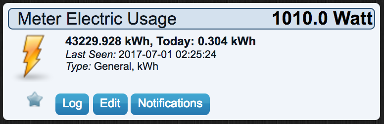

Domoticz virtual sensor type: Electricity (Instant+Counter)

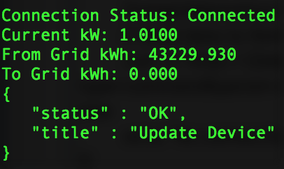

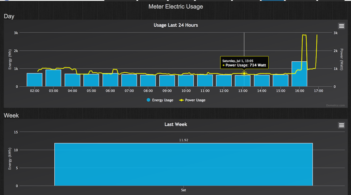

Bash terminal output should look similar to this:
