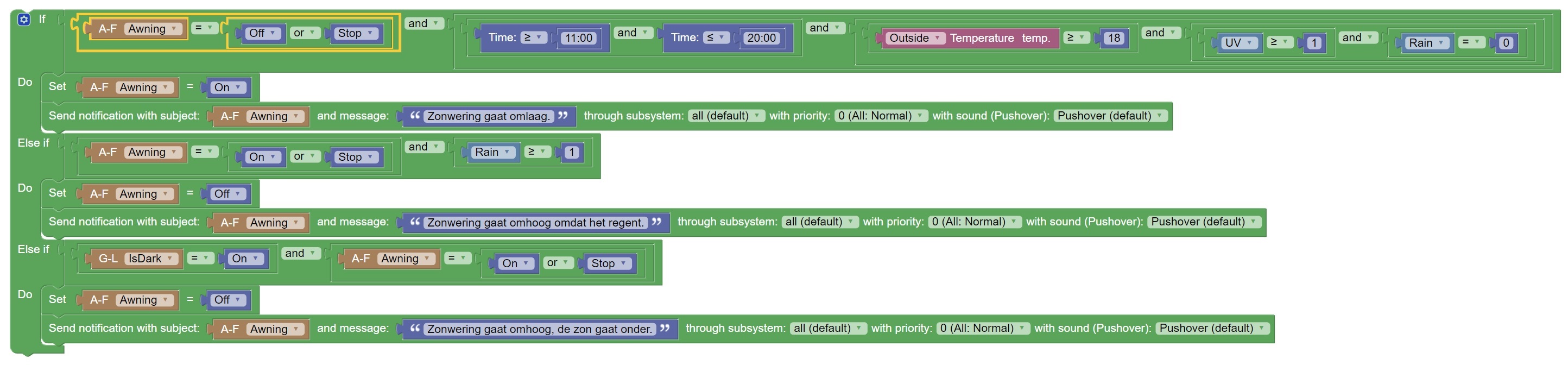

I am creating a blockly to automate the sunscreen (Awning) in the garden.
The goal:
If the sunscreen is not down (Off or Stop) AND it's between 11:00 and 20:00 AND it isn't raining AND it's 18+c outside AND UV is equal or more then 1 --> Go down (On)
If it rains go up, only if On or Stop (So when it's down halfway or completely)
If IsDark (1 hour before sunset) is On go up. (Off)
At the moment it does not seem to respond.
It does respond if I remove the Off or Stop part.
I have tried different variations for Off Stop On commands. The sunscreen seems to respond to on and off signals. Can someone help me out?
I have looked at various LUA scripts on this forum but, to me, they seem quite complicated and I have no clue what to fill in to make those work.
Can someone tell me what I am doing wrong?

you can't use 'if [switch] = [off or stop]', you'll have to use 'if [switch] = [off] or [switch] = [stop]'

tozzke wrote:you can't use 'if [switch] = [off or stop]', you'll have to use 'if [switch] = [off] or [switch] = [stop]'
Ok! I will try that!
The rest seems fine to you?
