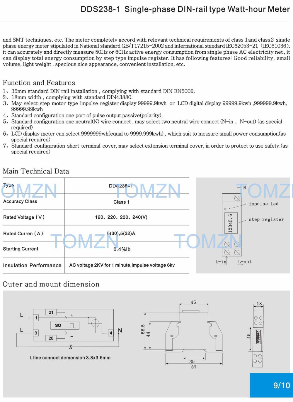

This topic describes to connect the cheap DDS238-1 S0 pulse energy meter (without the RS485 that is the DDS238-1ZN) direct to the raspberry GPIO
I could not find a topic for the simple S0 energy meter
Aliexpress https://nl.aliexpress.com/item/5-32-A-2 ... 0.0.SuQ44h
or any other cheap counter. This counter has 1000 pulses, if u use a different one recalculate the power use
connections
Port 22 (plus) of the DDS238 is connected to Raspberry 5v (pin 2 or 4)
Port 20 (minus) of the DDS238 is connected to Raspberry GPIO-13 (pin 33)
Function of the script
This script sends the counter and the power
The script reads from domoticz the last value of the meter, if this is a first start, take a preset
Every pulse is 1/1000 Kw = 1 Watt

Why not using Domoticz with the S0-interface connected as pulse-counter for energy?
Search in Domoticz' wiki for implementations.
You don't mention, but for good operation of the S0-interface, the read-out of pin22 of the kWh-meter is OK, but don't forget the pull-up resistor between pin22 and the raspberry's 3V3-power supply.
