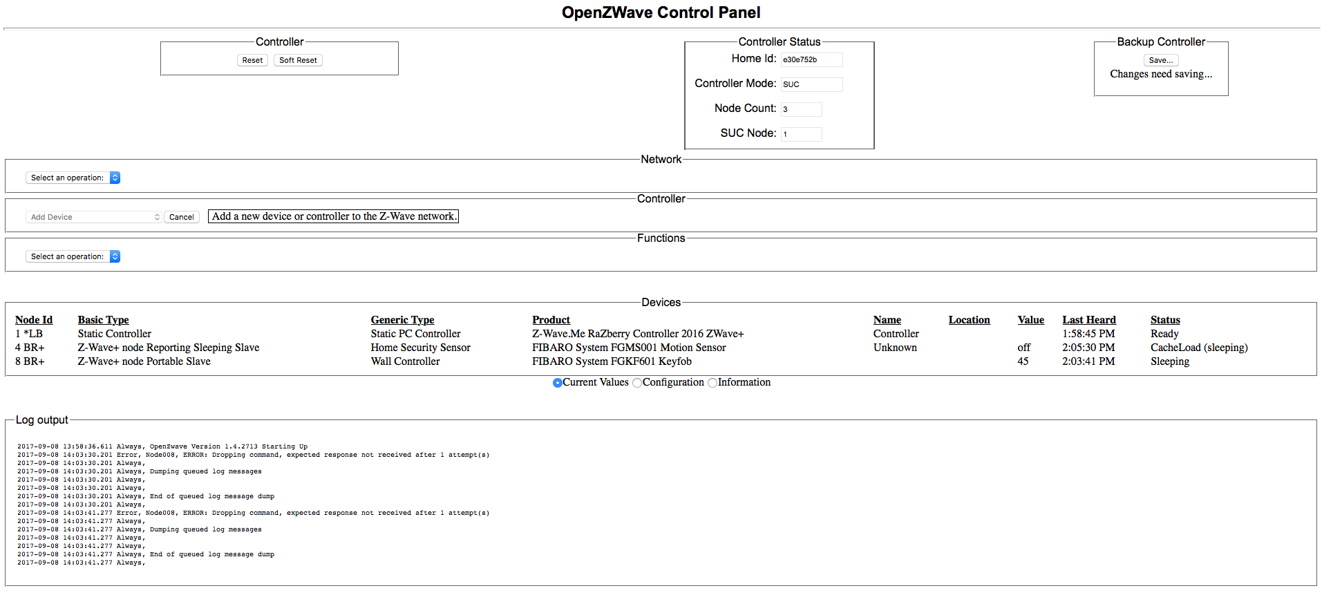

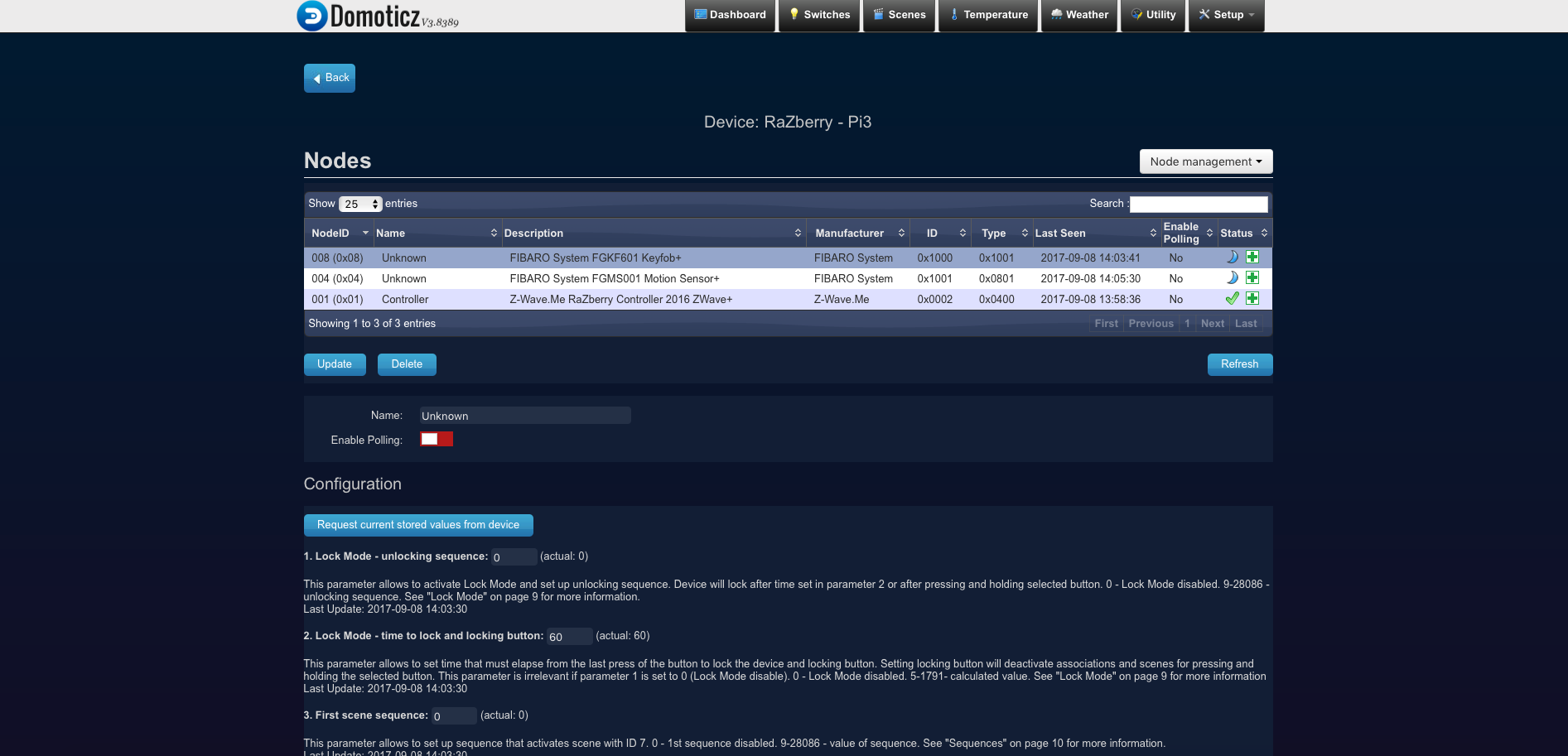

Hi.
I don't get this up-and-running on my Domoticz installation.
I can include the Fibaro Keyfob correctly but no new devices (switches / button (or combination of buttons) ? ) are added to the list of available devices. And I don't understand what exactly you are meaning with that group configuration. Does that have any influence? Or what am I doing wrong or goes wrong here with my installation? I've attached some print screens of how the configuration looks like right now.
I would like to trigger the execution of some bash scripts from those buttons (for various kind of stuff, for example starting a radio stream on my Pi).
Any help is welcome.
