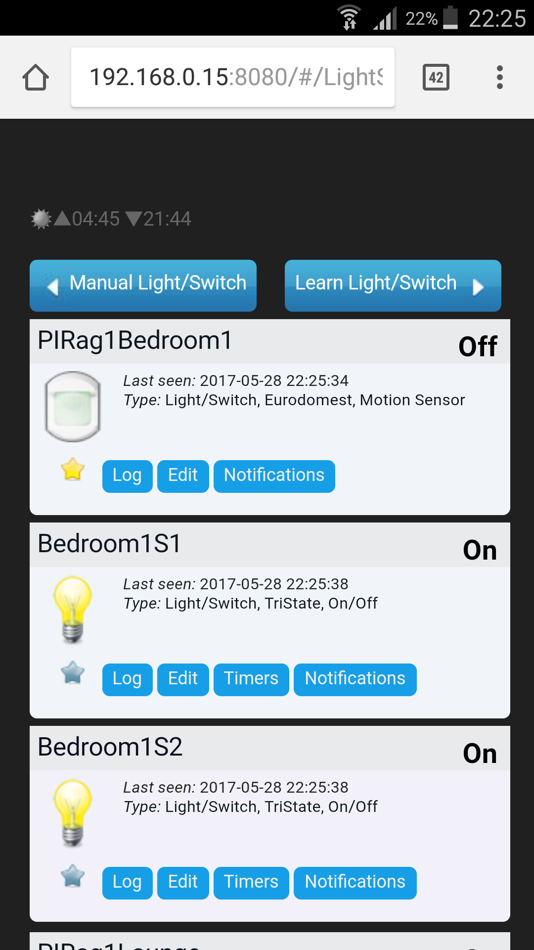

Here's a screenshot from the dashboard which logically shows that Domoticz *thinks* it has turned on the 2 switches:-
