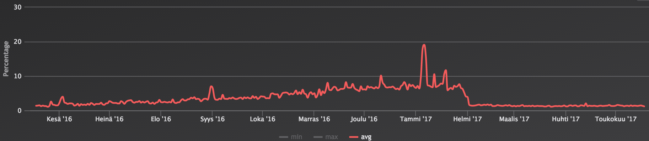

Nautilus
Posts: 722
Location: Finland
Re: Speed Domoticz
Post by Nautilus »
Well, that also depends partly on whether you have them in the file system as text files or in the database. File system is definitely faster. The speed increase (if talking about just the minimum reaction time to certain event) is perhaps debatable in case you move to e.g. single master script but at least on RPi2 that made a huge impact on CPU usage and thus to overall responsiveness as well (which often translates to improved reaction speed as well :)):
Screen Shot 2017-05-18 at 13.01.33.png (152.18 KiB) Viewed 3422 times
You can see CPU steadily increasing as I kept adding more scripts. The drop comes from moving to a single master (device) script after which I've kept adding stuff to be processed with the master script but CPU usage has remained steady.

thanks for your comprehensive answer.
just to be sure, I have many PIR scripts with in the if devicechanged......
If I put them in 1 script that would work?
they are on the filesystem. a mounted share from a nas ( to save my sdcard) that made domoticz a little faster

qwerk wrote: just to be sure, I have many PIR scripts with in the if devicechanged......
Yes, you'll see some improvement each time you make the number of scripts fewer. As mentioned, I currently have only one (master) script which calls (with dofile) other script files to make it a bit easier to manage stuff (compared to having everything in s single file). As Siewert above describes, this kind of approach returns only a single commandArray from each device change.
