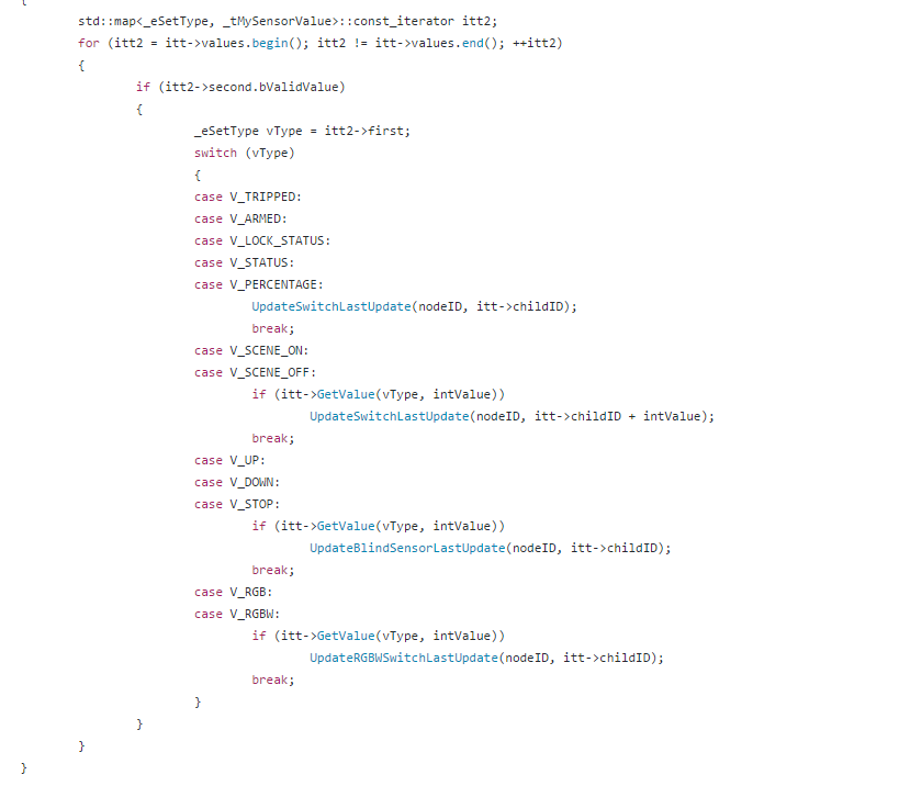

Not yet solved ... i have Domoticz V4.10717 (latest ) and still a bugged percentage bar and no status. I full open(100%) the shutter/blind and still saying closed.
That's the code of mysensors relay shutter module: Easy to replicate.It's just an arduino and an rfm69 or nrf24...relays are not needed for tests.
i can't help more because i'm no programmer :(
