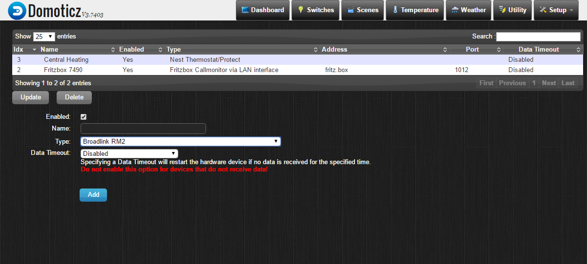

You can see that Python plug-in is loaded (I upgraded to 3.5.3), and also to the latest Beta of Domoticz, so I'm now at a loss as to what's going wrong with it only "half working" - by that, I mean I can't configure it, as per the dialogue box below:
domoticz problem.png (119.29 KiB) Viewed 1047 times
Does anyone have any idea what I can do to get this working properly...? As you can see from the box, my Domoticz build is 3.7403 and I'm running this on a Pi if that's relevant. I've tried renaming the plugin subfolder from "BroadlinkRM2" to "broadlinkRM2" as I've seen it used interchangeably with and without the initial capital letter - it doesn't seem to make any difference.
Here's the initial part of plugin.py in the plugins/broadlinkRM2 folder: it DOES seem to have the necessary parts that would (or should!) be creating the dialogue box to enter the IP address etc. But as you can see in the screen shot above, they're just not happening... :roll:
