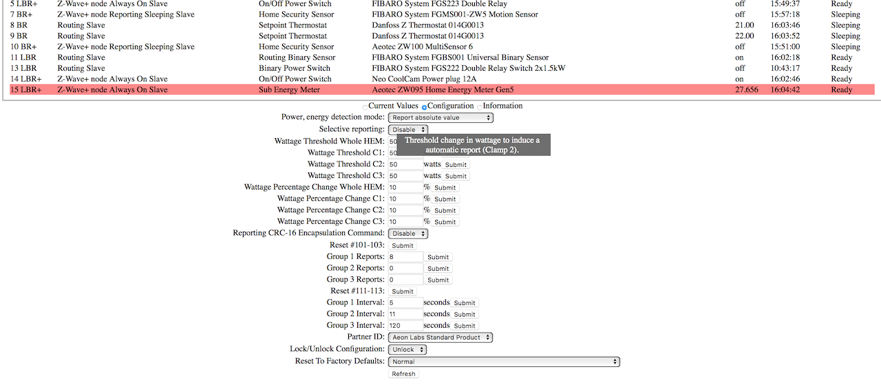

Re: Aeotec Home Energy Meter Generation 5 Support
How do you do update software?
Where you find software?
I use HEM gen5 3 clams.
I see in domoticz only Watt - from all clams (daily and total), Voltage (no refresh).
I want to see Watt for C1, C2, C3 - it is possible?
Regards,
Przemek
Regards,
Przemek
i know that but this not working for me.
I set refreshing 5 sec.
When i put in 101 - "8" - something working - like this in log on domtoicz:
"2017-09-16 16:02:52.032 (AeonZ-wave5G) Current (Unknown)"
"2017-09-16 16:02:57.032 (AeonZ-wave5G) Current (Unknown)"
When i put 15
"2017-09-16 16:21:47.030 (AeonZ-wave5G) General/Voltage (Voltage)
2017-09-16 16:21:47.127 (AeonZ-wave5G) Current (Unknown)
2017-09-16 16:21:47.321 (AeonZ-wave5G) Usage (Usage HEMg5)
2017-09-16 16:21:47.419 (AeonZ-wave5G) General/kWh (kWh Meter - HEMG5)
2017-09-16 16:21:47.513 (AeonZ-wave5G) General/kWh (kWh Meter - HEMG5)
2017-09-16 16:21:52.030 (AeonZ-wave5G) General/Voltage (Voltage)
2017-09-16 16:21:52.127 (AeonZ-wave5G) Current (Unknown)
2017-09-16 16:21:52.321 (AeonZ-wave5G) Usage (Usage HEMg5)
2017-09-16 16:21:52.418 (AeonZ-wave5G) General/kWh (kWh Meter - HEMG5)
2017-09-16 16:21:52.514 (AeonZ-wave5G) General/kWh (kWh Meter - HEMG5)"
Its ok.
But if i put 271 - log:
"2017-09-16 16:26:27.030 (AeonZ-wave5G) General/Voltage (Voltage)
2017-09-16 16:26:27.127 (AeonZ-wave5G) Current (Unknown)
2017-09-16 16:26:27.318 (AeonZ-wave5G) Usage (Usage HEMg5)
2017-09-16 16:26:27.412 (AeonZ-wave5G) General/kWh (kWh Meter - HEMG5)
2017-09-16 16:26:27.509 (AeonZ-wave5G) General/kWh (kWh Meter - HEMG5)
2017-09-16 16:26:32.030 (AeonZ-wave5G) General/Voltage (Voltage)
2017-09-16 16:26:32.127 (AeonZ-wave5G) Current (Unknown)
2017-09-16 16:26:32.320 (AeonZ-wave5G) Usage (Usage HEMg5)
2017-09-16 16:26:32.414 (AeonZ-wave5G) General/kWh (kWh Meter - HEMG5)
2017-09-16 16:26:32.510 (AeonZ-wave5G) General/kWh (kWh Meter - HEMG5)"
log its same like "15".
If i set 256 - no refreshing, no log, no working. Same for 512, 1024, 2048 etc.
In my domoticz (V3.8153) i can use 101,102 and 103 (Group Reports). All of them works but only 1,2,4,8,15.
Ragards,
Przemek
ps - sorry for my english.
When i put 15
Its ok.
Ragards,
Przemek
