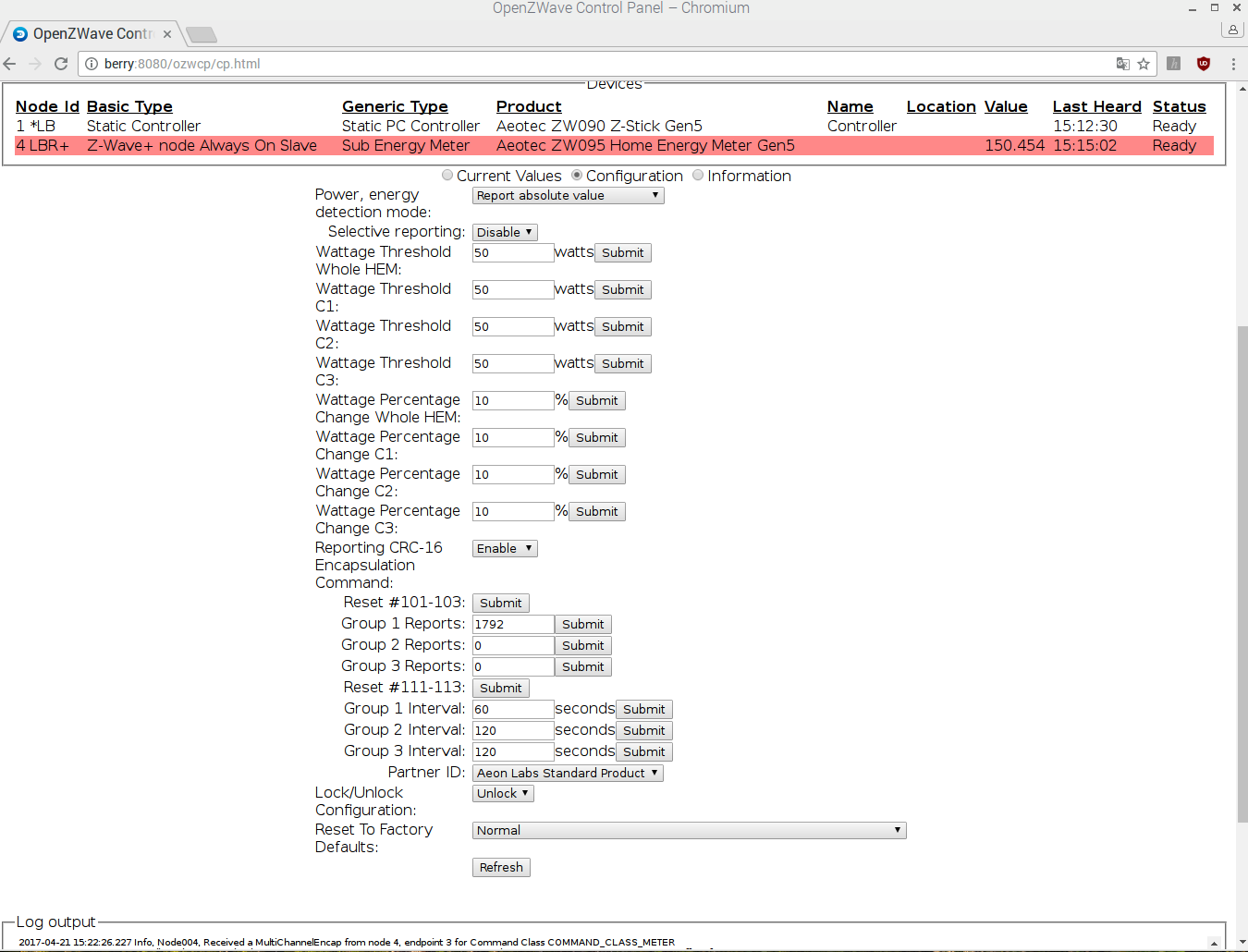

I am new to Domoticz and have some problem with getting an Aeotec HEM3 Gen 5 working. I am running Domoticz version 3.7373 on a Rapberry Pi with Raspian version 4.4.50-v7+. I am using an Aeotec Z-Stick Gen 5 as Z-wave controller. Both haredware are included and configured. The HEM is configured to report wattage for each clamp in Group 1 each 60 second. The other groups are not used. See the appended HEM3Gen5 Control Panel image.

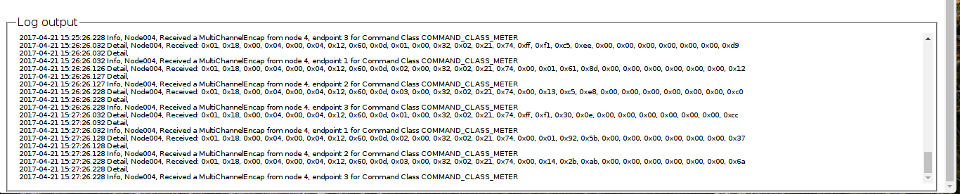

Checking the log in the control panel the HEM sends three reports each 60 second. See the HEM3Gen5 Control Panel Log image. The reports com from endpoint1, endpoint2 and endpoint3 which I assume are the clamps. The Z-wave configuration is thus working as expected.

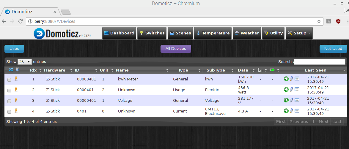

The strange thing is how this is displayed in Domoticz. Have a look at the Domoticz-Devices image. As you can see I got a kWh meter, a voltage meter and a current meter. Nothing that I have configured for. The current meter is displayed as an CM113 Eelctrisave decive. This is an OWL piece of equipment and nothing I have in my Z-Wave network. There is only one wattage report but it is not possible to see what it comes from.
My big question is thus how I can make Domoticz detect the three endpoints.
