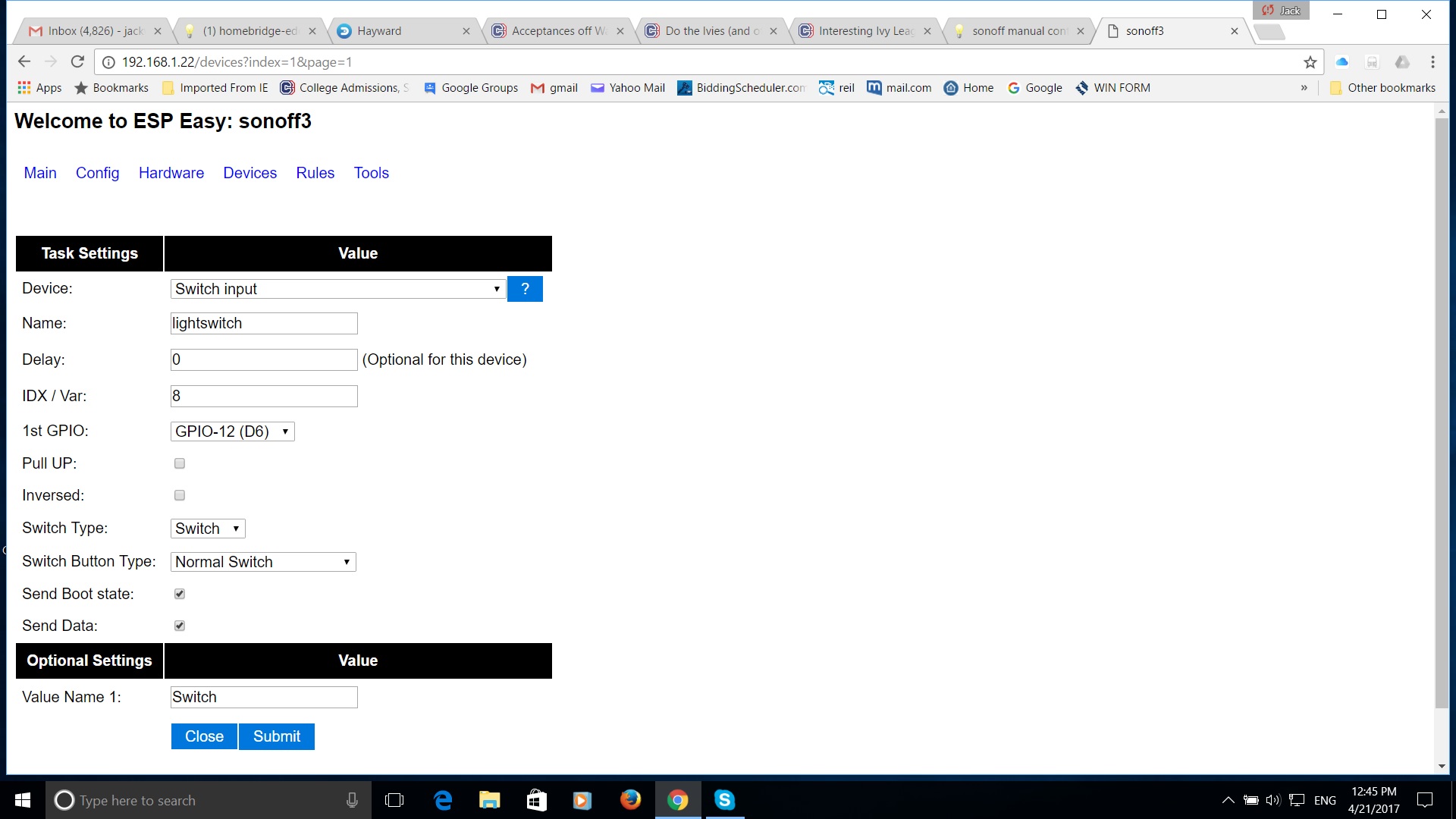

I created a virtual switch in domoticz for my sonoff(basic) device flashed with espeasy R147
I do not have problem to control the switch via domoticz or apple app Pilot
However, I just realize that manual control switch (GPIO0) is not working properly
I did put in the following standard rules in espeasy
on lightswitch#Switch do
if [status#Switch]=0
gpio,12,1
gpio,12,0
endif
endon
I have the following problems
1. If the sonoff is turned on by software, I can press the gpio0 button to turn it off, but cannot turn it on.
2. If the sonoff is turned off by software, I cannot press the button to turn it on
3. If I manually turn off the sonoff, domoticz does not report its been turned off
I am using http to control the switch in domoticz
Please help

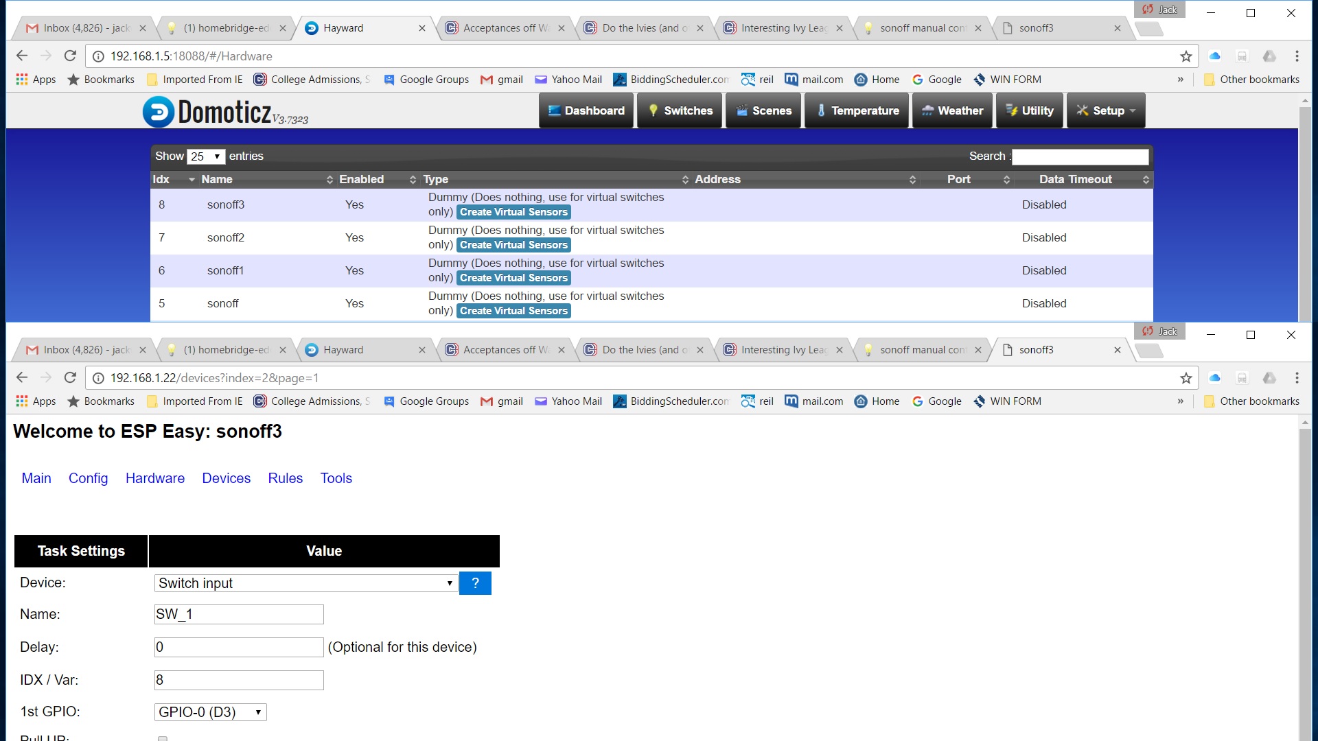

Maybe I did some thing wrong. The thing I am always wondering is that in the Hardware entry(Dummy), should I create One Sonoff per HW entry or can I have many switches per HW entry? I put 3 Sonoffs under one HW entry and the idx I used are the same in Espeasy.
jackwan1
- Posts: 41
- Joined: Saturday 15 April 2017 20:04
- Domoticz version: 2020.2
- Location: USA
Re: sonoff manual control
Here is my setup
I have since added separate HW definitions but still did not work

- Westcott
- Posts: 423
- Joined: Tuesday 09 December 2014 17:04
- Location: UK - Glos
Hi Jackwan1,
What you seem to have done is created 4 hardware nodes in Domoticz and used their idxes.
What I think you need to do is have just one hardware node 'Sonoff' and create 4 dummy switches in it - Sonoff1-4.
Then use the idxes of these dummy switches in the ESPeasy devices.
jackwan1
- Posts: 41
- Location: USA
But I did exactly as you described before. I created one Dummy Switch and put all virtual sensors (sonoff switches) under that HW switch.
It did not report the correct status of the switch as I described before. The virtual Idx under "device"was entered and did not work

ok, now I deleted all the settings and start from scratch. The confusion is the Dummy HW idx and the Virtual Switch idx on the device list. Which one I should use in the espeasy? And if they are identical would that cause problems? Like right now the Dummy HW idx is 2 and one of the virtual switch also has idx 2.
jackwan1
- Posts: 41
- Location: USA
Ok, its all good. By trial and error, I now know that the idx in "Device" list is going to be used not the idx in the"Hardware" list should be used. The status sync is all good.

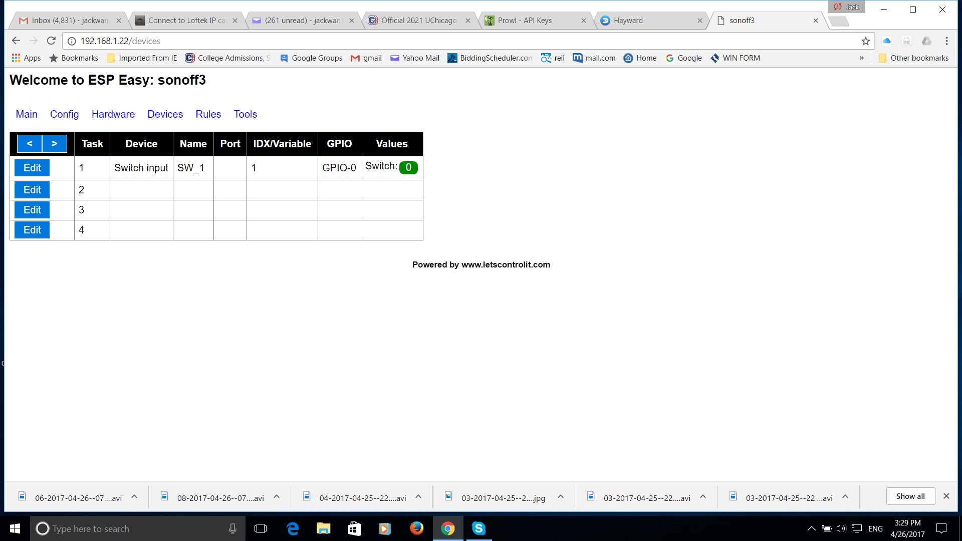

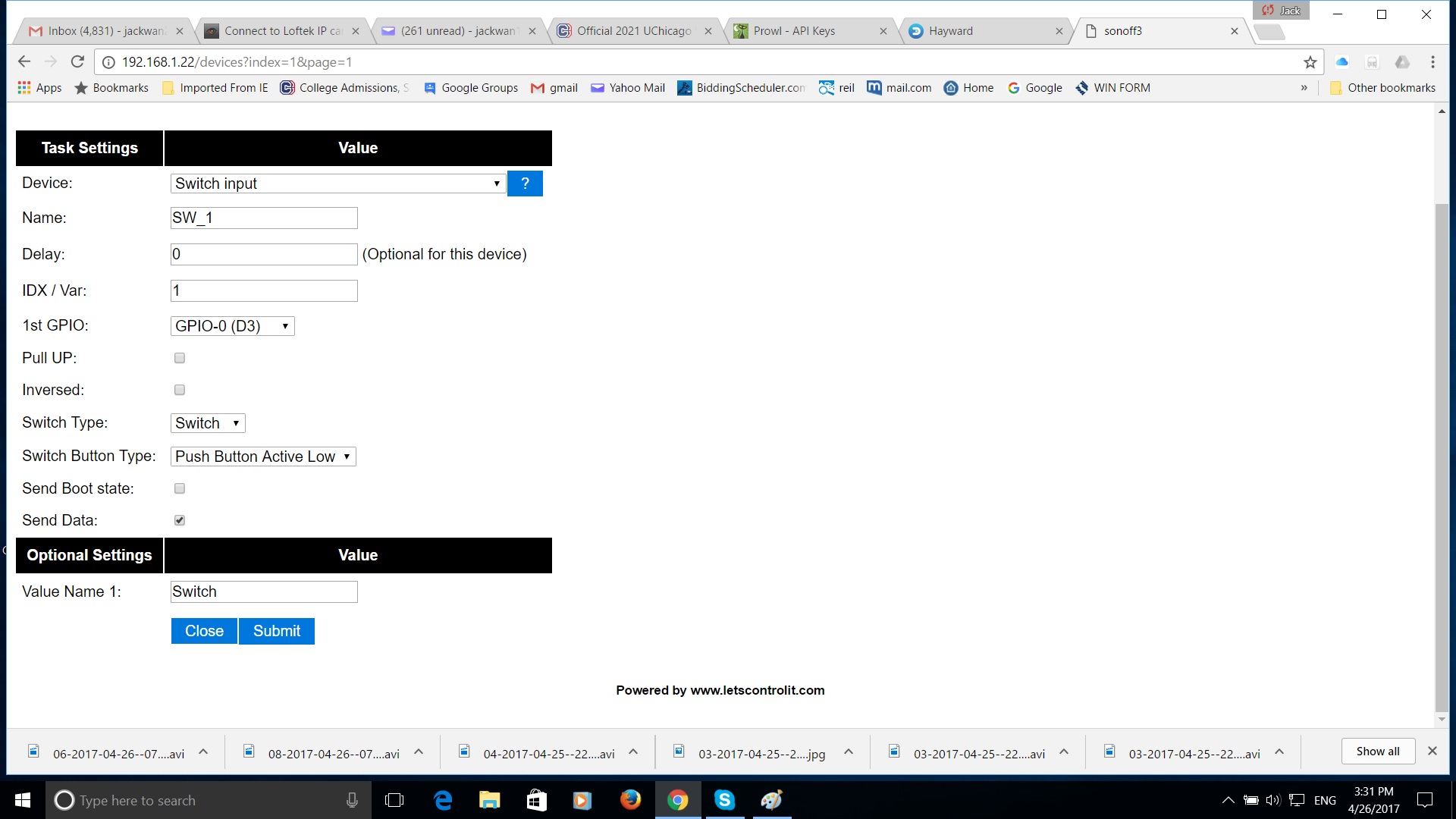

Thanks to @sinze who spent the time to set up sonoff switch in Domoticz using the procedures in the following thread:
https://www.domoticz.com/forum/viewtopi ... 20#p121751
It worked fine, but strangely, I receive two prowl notifications each time I turn on and off using Domoticz
Further investigation found that in the Domoticz switch log there were two entries each for on and off
Trial and error found that there is nothing wrong with his Domoticz setup but the Espeasy setting needs to be modified as follows:
1. In ESPeasy devices there should be only ONE switch device entry:
The double entries in Domoticz log is caused by TWO switch Espeasy device entries as defined by @Sincz. 2. There is a slight change in the Switch setting:
Please note that Idx in the switch setting is significant, mine is 1, yours could be some thing else. That idx should correspond with your switch(device) setting in the Domoticz
There is no change in Espeasy rules as @sinze posted.
Its all good from there
