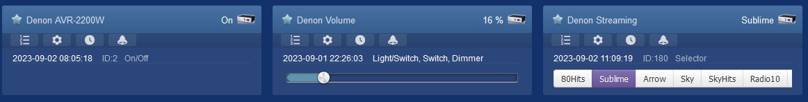

Domoticz setup is below..
Three dummy switches have been created (no specific setup required in those switches):
Receiver switches
Receiver switches

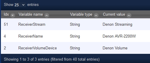

I’ve defined several DzVents script and I’m also using user variables to make my scripts more independent. The variable names are used in the scripts, the current value of the value is the exact name of the switch.
Receiver user variables
Stream user variable
In next section the scripts will be shown.
