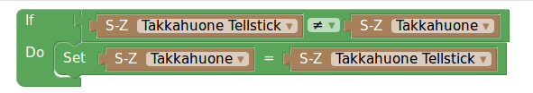

I'm trying to copy state of "Takkahuone Tellstick" to "Takkahuone".
The attached blocky creates error "Error: EventSystem: Malformed action sequence!"
Maybe I need to do separate check for On/Off and then set to On or Off? Not copy switch state like that. But it's weird that direct copy doesn't work, don't you think?
Screenshot at 2017-04-09 14-00-46.png (9.46 KiB) Viewed 1088 times

Ended up doing it in lua instead:
if (devicechanged['Takkahuone'] == 'On' and otherdevices['Takkahuone Tellstick'] == 'Off') then
        commandArray['Takkahuone Tellstick']='On'
elseif (devicechanged['Takkahuone'] == 'Off' and otherdevices['Takkahuone Tellstick'] == 'On') then
        commandArray['Takkahuone Tellstick']='Off'
elseif (devicechanged['Takkahuone Tellstick'] == 'On' and otherdevices['Takkahuone'] == 'Off') then
        commandArray['Takkahuone']='On'
elseif (devicechanged['Takkahuone Tellstick'] == 'Off' and otherdevices['Takkahuone'] == 'On') then
        commandArray['Takkahuone']='Off'
return commandArray
Works fine, and works in both directions.
