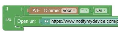

sms push message2.jpg (9.06 KiB) Viewed 1817 times
Hi orbitcoms,
blocky works for me. make sure you use the quotes, see my screenshot.
hope it works for you!
