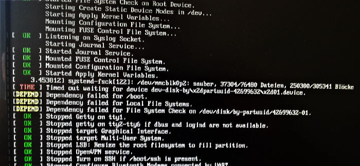

After following the instructions for using overlayfs, the rpi does not boot anymore.
It hangs when trying to detect the boot device
a timer runs for 1:30 minutes: 'a start job is running for dev-mmcblk0p1.device'
after which the startup process continues but the /boot device cannot be found
At the end it goes into emergency mode, but you can't do anything there.

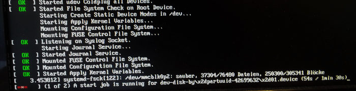

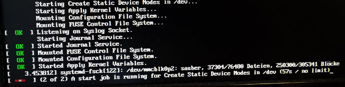

Its nearly the same on my jessie-system(2017-04-10-raspbian-jessie-lite - I also gave it a try on my Debian x86 vm with the same result) - in detail, as long as I don`t try to mount /var as overlayfs everything is fine, /home gets mounted as an overlayfs. After activation the fstab-line with the /var folder(instead of bind /var_org to /var), the system seems not to be able to generate the static device nodes in /dev and - I guess - because of this its not able to mount /boot.
I don`t really have a clue what's interfering with /var, or what systemd(?) is messing up at this early stage.. I would be very happy if someone could help me to solve the problem!
