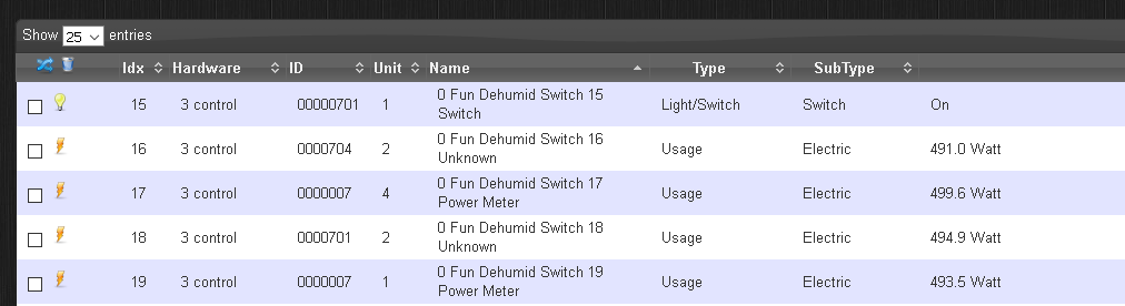

Domoticz version: 3.7153
Fibaro Wall plug type: FGWPE/F 102
I have one switch and four power sensor devices. All of the four power sensors report load, not energy.
device list.png (22.69 KiB) Viewed 612 times

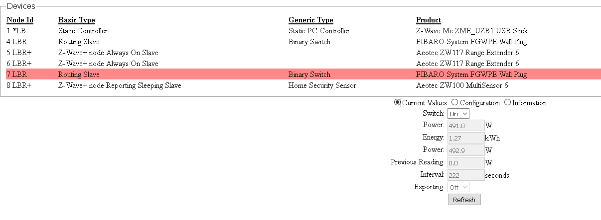

However OpenZwave Controlpanel reports energy.
openzwave cp.png (17.38 KiB) Viewed 612 times
Then 2 power sensor devices stopped responding.
I have two identical Fibaro plugs. Both show exactely the same behaviour.
Help highly appreciated.
