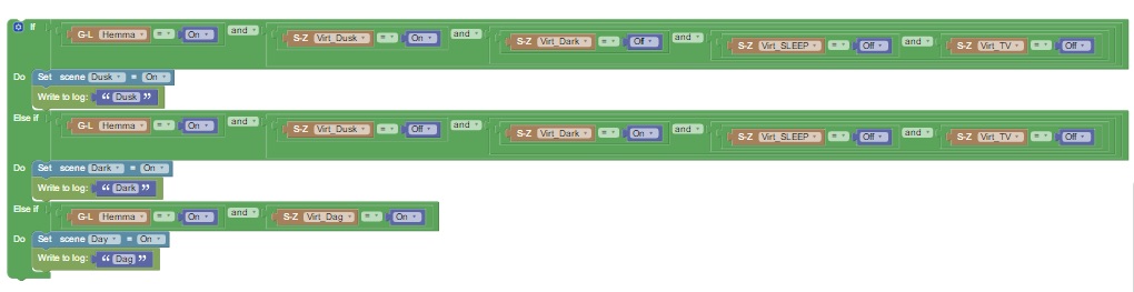

Greetings.
I'am trying to convert a few of my blockys to LUA, but its not working out.
Here are the blocky original:
Blocky Vanligt.jpg (58.19 KiB) Viewed 2301 times
Here my LUA code :

Should I rename all "otherdevices" to "devicechanged" as some switches might change or should I make a new elseif for each one that can change ?
If anyone have a good page for the first few steps on how LUA are working please send it to me =)
I've tried to read the lua guide on the wiki, but its going to fast over my head on how to start LOL
Regards Magnus Svensson
