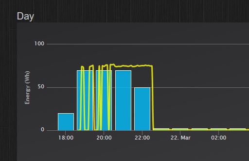

I believe this is an old problem which is still not fixed(because it might be a fibaro problem)
i have kWh devices which are generrated for the following devices
FGWPE zw5
FD212 zw5
normally i have polling on those devices and then evrerything works as expected
when i turn polling off the wattage on kWh meter fluctuates. it seems like the device is going off anfd on but the module itself is on and stays on.
i only have this behaviour with the kWh device
The watt device is on and stays on
when polling is turned off it jumps up and down, when polling is on it stays on like it should because the module is turned on.
please note that the real power output stays on, it is only the reading.

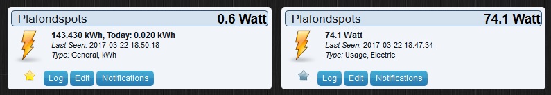

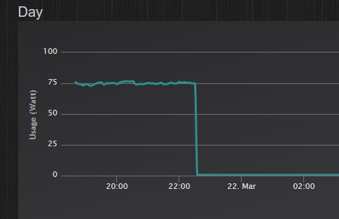

here the kWh and the watt device output from the same FGWPF zw5 module
the strange thing is when you look at the devices itself you see the watt on the watt device stays on while the watt on the kWh device goes to 0
this should be exactly the same value so aparently this is reported differently
