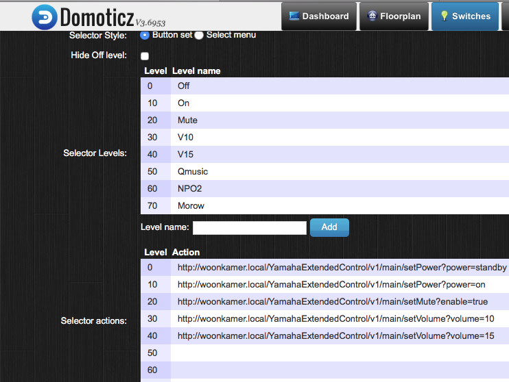

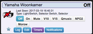

Based on the API description i did a quick hack using a Domoticz Selector switch. This works, I can switch the receiver On and Standby, and set a volume level.
Please note that the buttons for specific radio stations have not been defined yet.
Some pics below with detailed information.
Schermafbeelding 2017-03-19 om 16.40.38.png (35.12 KiB) Viewed 5586 times
Schermafbeelding 2017-03-19 om 16.41.00.png (163.84 KiB) Viewed 5586 times
Maybe this info is of use to others.

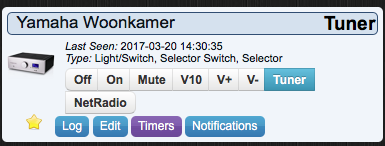

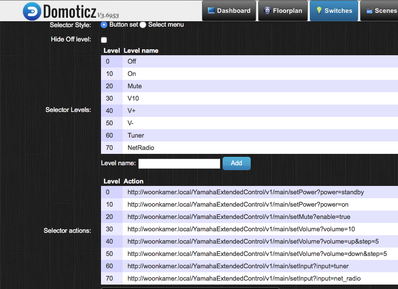

Update with some additional commands.
Schermafbeelding 2017-03-20 om 14.33.30.png (34.92 KiB) Viewed 5570 times
Schermafbeelding 2017-03-20 om 14.33.43.png (195.9 KiB) Viewed 5570 times
