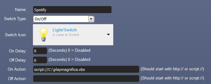

nice work,unfortunately I want to use spotify!
I found a VBS that does the same thing for spotify and when started by windows operating properly but if started from domoticz Virtual Switch does not work.
In LOG everything seems to start correctly but it really does not access anything.
Play Command.JPG (28.64 KiB) Viewed 2017 times
Log Play.JPG (17.92 KiB) Viewed 2017 times
Do you have a suggestion for me?

Is the windows account an administrator one? ( I'm not sure if that matters, but it could be a permission thing?
Initially I was running the vbs files from a .bat file. So domoticz would link to the .bat file, and that triggers the vbs. so you could try that. Though I found in the end that linking straight to the vbs worked.
If you can't get it to work, it could be worth having a look at powershel. I found lots more options than vbs.

Yes,adminitrator!
i can try to run a VBS from a .bat but same things,under windows work in domoticz "Executing script.." but nothing happens..
sion
Posts: 113
Joined: Friday 08 January 2016 12:32
Re: Control itunes on windows, from domoticz / echo alexa etc..
Post by sion »
Not really sure to be honest why it's not working. Works fine for me.
When you press the button in domoticz that triggers the .bat file, can you see the file open briefly on screen? ( would just be a black box that opens briefly. )
Also, justcto check, when toy just double click the bat file, that works correctly?
