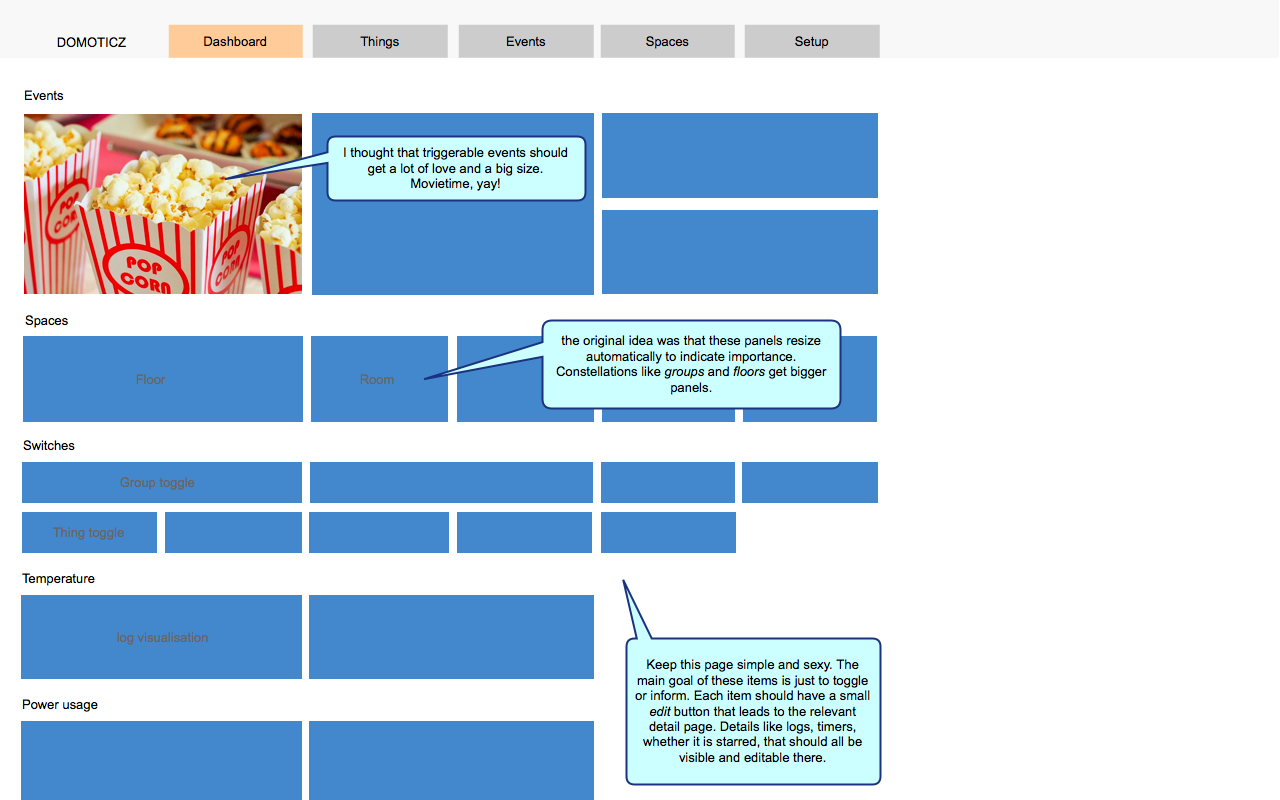

DASHBOARD
This is similar to the current dashboard. One small difference is that all buttons should have a small button inside of it to quickly dive into settings.It might be an idea to create tabs at the top such as "Overview, Floor 1, Floor 2" if the user has in fact created floors.

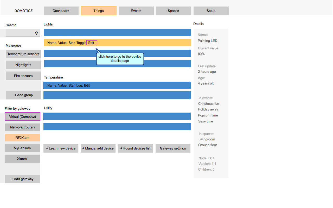

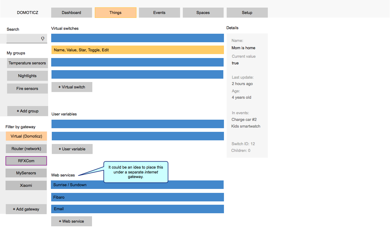

THINGS
People need a simple mental model of their system. In this design everything connects through a gateway. The users’s ethernet router is also a gateway in this sense, as is the internal USB or bluetooth connection. Domoticz always connects through something, and this allows for a logical grouping of end-nodes:
Virtual switches are also grouped here. This is perhaps radical, but I’ve proposed that data-sources form the internet are shown here too, instead of in the setup menu. The current sun-up and sun-down times could be a 'thing' here (a sensor), as could things like Fibaro or even email (as a virtual actuator of sorts). In the future the webservices could perhaps also be under their own “internet” gateway.
In short you could say that ‘things’ is the place where you manage all the inputs or outputs for the event system:

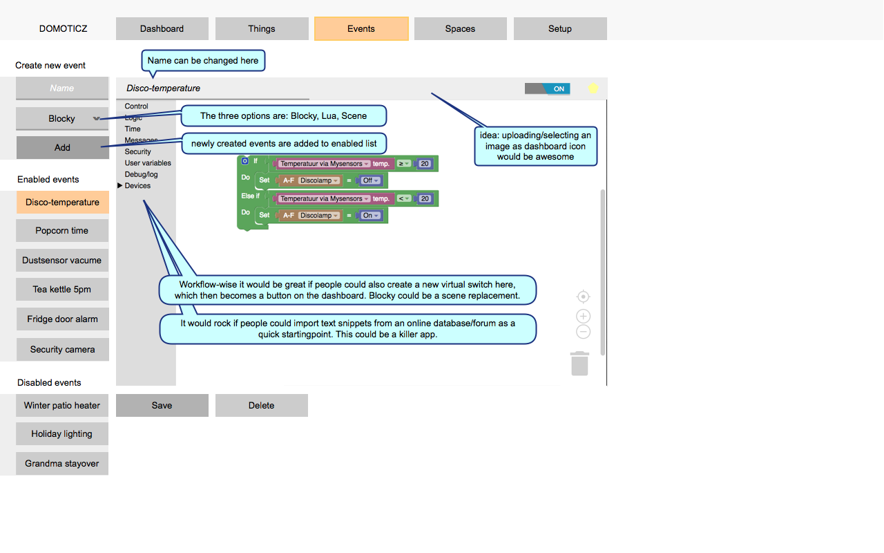

EVENTS (& SCENES)
This is the place for all temporal-based logic (in contrast with all spatially oriented constellations under the rooms and groups tab). Scenes can be found here, but my main focus was to give more love to the Blocky builder, which I think it a real unique selling point and killer app of Domoticz. For me, it’s why I stuck with it. I didn’t understand why it was so hidden.
In the list on the left side I have made no distinction between Blocky, Lua or Scene events, but they could easily be unmixed and ordered by type. I also played with the idea of tabs at the top to separate all three types of logic, but thought the simplicity shown here would be ok for most domestic use cases. Ordering them by tab could perhaps be a power-user option.

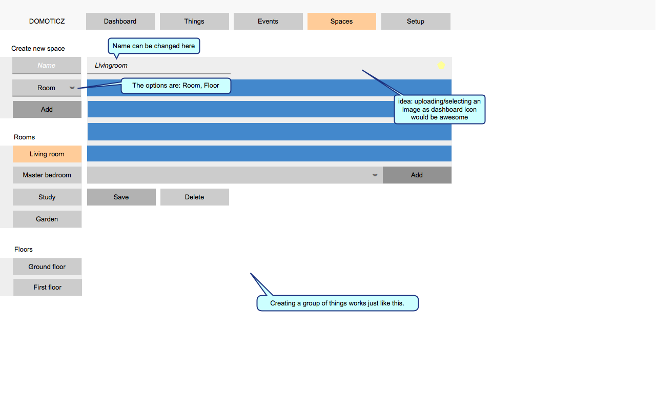

SPACES
Where you could say that 'events' is about temporal logic, this is about steady spatial organization of things. Floors are just a special type of room that also has a map. I must admit I don't use this feature personally.

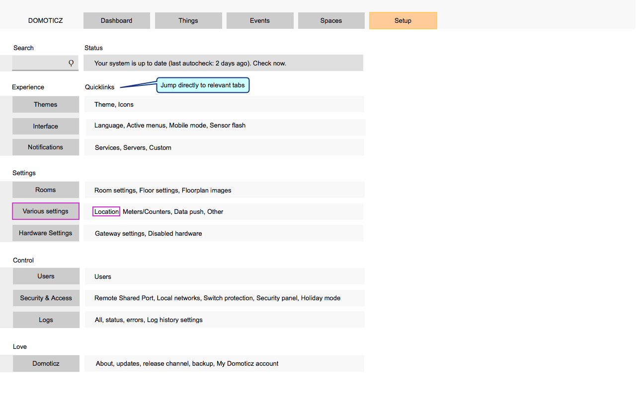

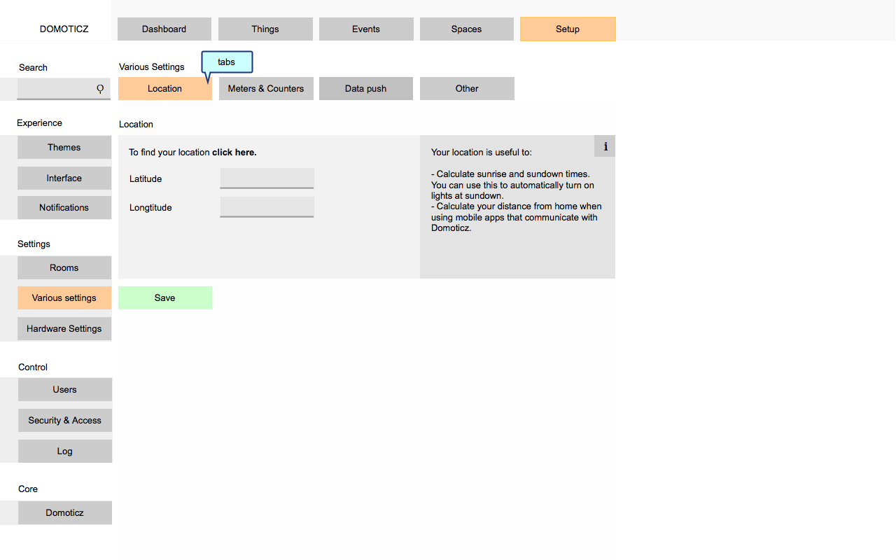

SETUP
Here I spent some time rethinking where I would put things, and how they could be categorized. It's not perfect, but it's a start. I also think a built-in help function would be useful. The overview page would offer quick links to the various pages.
Here you can see the idea of putting 'help' a bit more center stage:

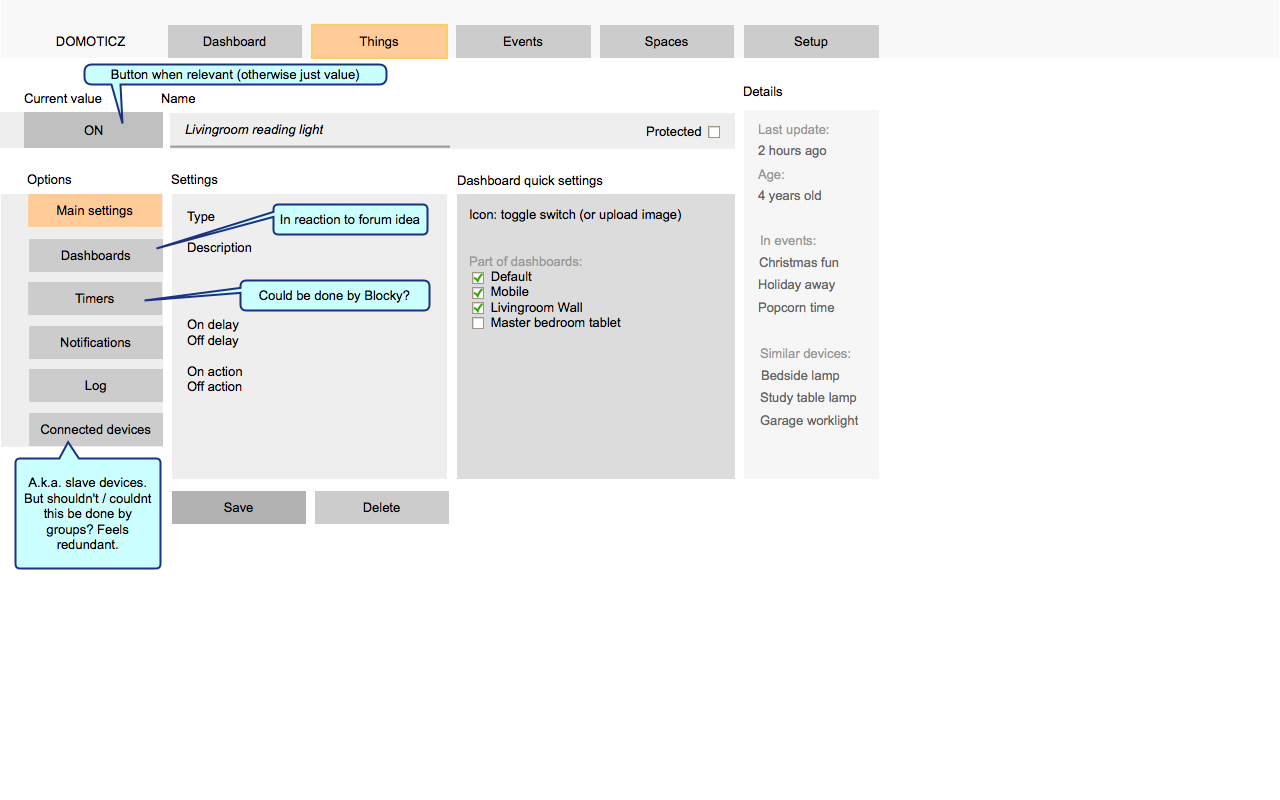

//ADDITION: THING PAGE
In response to the conversation below I created a detail page for a thing. It hints at the idea that it would be useful to have multiple dashboards.It also made me realize that 'timers' could be the 4th event-type under events. It would be my adviceto explore if Blocky could be used to also replace the timers functionality. Keep all intelligence in one place.

- If reaching a wider audience is the goal, I think the Blocky interface could be put more center-stage. It could become the center for creating scenes instead of the current separate scenes system. The Domoticz systems is currently more powerful than even commercial systems like Homey:
https://www.youtube.com/watch?v=pztkJfZO2u0

Regarding the desktop.. one thing that makes this work or break is the way to configure the dashboard. That's a whole different beast regarding UI. Have you looked into that as well? I guess there should be some palette with all devices/charts/whatevers that can be dragged-and-dropped to the dashboard. Tile selection with properties (controlling dimensions, titles, icons, controls etc).
Another thing is that I think there should not be just one dashboard. I think we should support multiple dashboards. Each dashboard can have different usages. Each user for instance can have is own. Or when you have some iPads around in various locations you can imagine that each has it's own contextual dashboard. Or that you want a dashboard specifically for heating-related stuff or one for lighting around the house etc etc.
I believe the dashboard(s) is the cornerstone of the entire UI. The place where people will be around the most. I wonder if dashboards and floorplans shouldn't be merged into one...guess that's what you intended with Spaces. So maybe you can define layouts per space and have it accessible as a dashboard.
Cheers!
Danny

I agree wholly, although so far I purposefully didn't want to go too far overboard. I've added a thing-detail page that hints at this functionality.

The one thing i noticed that im not a huge fan of is the buttons at the bottom for adding/learning a light etc. If you force those to always be visable then its wasted space, but who wants to scroll to the bottom to get to those? i have a good deal of switches and that would be annoying... i'd say wither layer them at the top (i've seen some nice compact multi layer tabs) or toss it on the left, which by the way i LOVE... you could change the filter to a dropdown to make more room for those buttons.. hell you could most the filter dropdown to the top right, which is the typical location for a filter anyways..
at any rate, i love that you're doing this... the UI is ok with Domoticz, but its certainly its weakest point!
