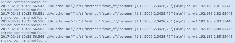

In the mean time I found the following in the log-file
log file nc command
log file nc command
Domoticz NC command.jpg (46.02 KiB) Viewed 1243 times
So the nc command can't be found by domoticz is my conclusion. For a "normal" user I put this in the PATH.
Can someone help me what to do that the commands in this PATH can be executed by domoticz also?
Is there a domoticz user on the system? Or do I have to change someing in my Apache settings? I really do not know.

Finally I solved it I installed BusyBox - The Swiss Army Knife of Embedded Linux on my Synology
http://www.mit.edu/afs.new/sipb/project ... syBox.html
and now the Synology also recognise the nc command (and many more)
Best regards Bert
