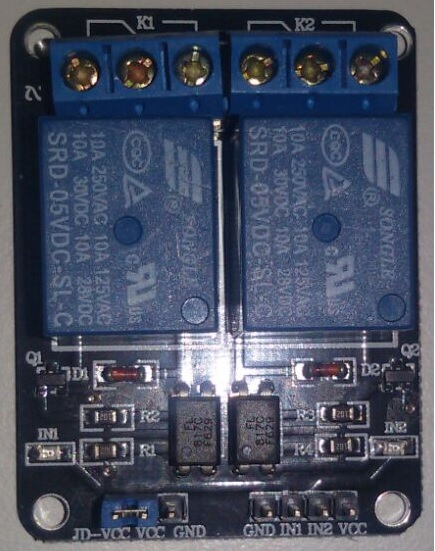

I have the 2 relay channel as in photo.
I don't touch the jumper. I connect the GND to GND PI3, VCC to +5V PI3 and IN1 to a pin of PI3. I follow the wiki to export as output the pin bcm 17 in my case.
When the PI3 start, pin 17 is in V 0 (from gpio readall) and the relay is fisical On and in Domoticz the virtual switch is Off. If i connected a light, i need to use the Com-Nc on the relay (because the relay is in security mode). But in this situation if the Pi3 shutdown the light put On forever.
It's possible to export the pin 17 in V 1, the ralay is fisical Off and in Domoticz the virtual switch is Off ???

Hi, I just read your post.
You need to invert your output of your RPI.
The relais is active low, this means that when your output is 0V your relais is active.
I used a ULN2003 to conevert my outputs. You can also check https://www.google.be/search?q=pnp+inve ... wvu5CezM:
