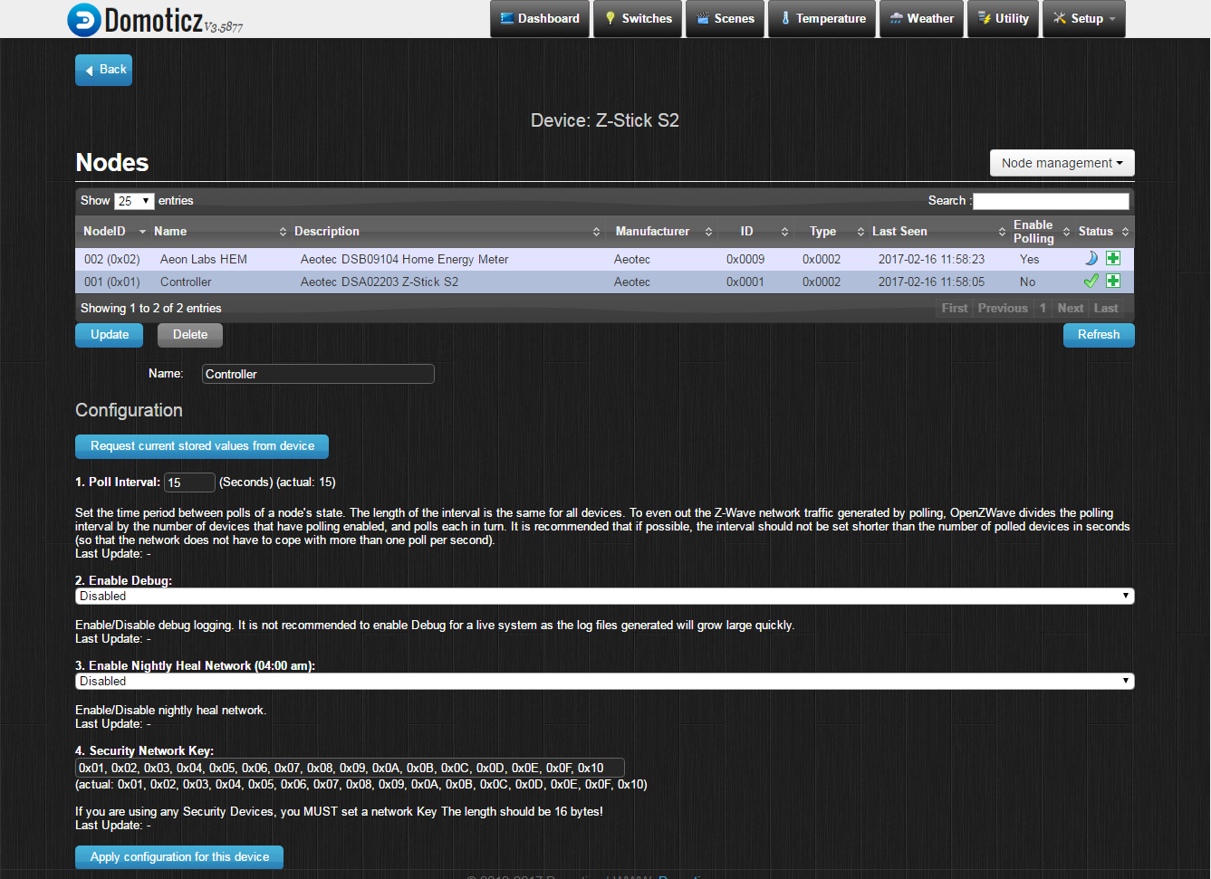

Node management seems to show that the HEM is asleep (partial moon icon)

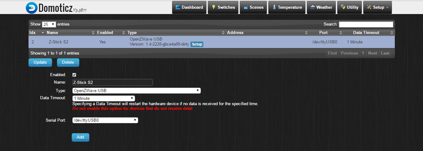

I only seem to get updates if I set data timeout on the stick to 1 minute.

I haven't been able to get the HEM watt and percent automatic report parameters to stick yet. It is reporting as asleep.

I just got the cheaper one in to test and try out.. It's the v1 unfortunately but I was able to get a week in about of polling before it stopped. I was having a similar issue at first though and it kept going to sleep and I only got the polls in when I refreshed the node from the OZW configuration page.
On the actual device enable polling on it was the trick for me to be able to get it to poll correctly, but as I mentioned, it stopped after about a week and had an exclamation mark. I just powered it down and it came back up and has been up for another week about...

Using 3Phase4Wires model with gen 5 stick. No problems at all. Take care of the wattage thresholds (50 in my case). Also, did you set the group reports (101) to the added value in the manual? Mine is 16135 (again for 3Phase4Wires Model zwave plus).
