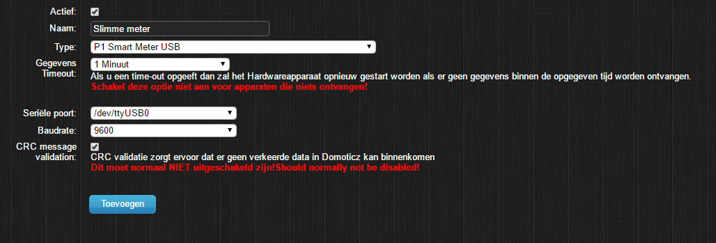

Then I added the hardware (sorry for the dutch language, but you get the point)
As a number of people discovered, no devices were added, and no additional log lines were added beyond these:
