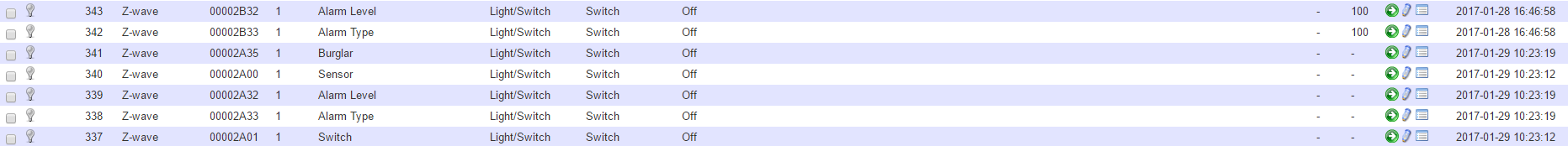

I've got this siren. It seems that there is no support from openzwave at this time. Domoticz incuded but there are no configuration options. any idea how to build this openzwave device ?

I've found the xml file of configurations. Still some thing are missing but is a good start as it has sound and light. I try to find how to get only visual alarm.Any help?
Here is the xml file you need to put under openzwave (/home/pi/domoticz/Config/devolo/). Also you need to edit /home/pi/domoticz/Config//manufacturer_specific.xml to add the path of xml file adding the xml the section
