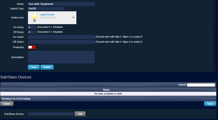

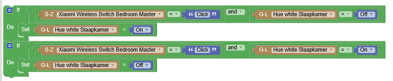

Hi, I have a Xiaomi Wireless Wall Switch and some HUE bulbs which I want to combine with Domoticz.
How can I configure the switch to control the HUE bulbs? I did some tests with Blockly, but nothing happens so far.
I do not have any experience with LUA yet so if that's needed I need a good instruction for dummies. :)
I also tried with the user variable described here and doesn't work either, but maybe I'm missing something.
Can someone tell me how I can set this up?

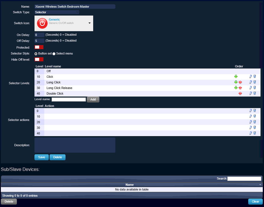

Current Scenario:
HUE bulbs and Xiaomi Wireless Switch are added in Domoticz, changed the switch type of the Xiaomi switch to "Selector" with 5 levels:
0-Off, 10-Click, 20-Long Click, 30-Long Click Release and 40-Double Click, but when I click on the switch the Off status always appears in the log.
When I click on the buttons in Domoticz the status is shown in the log, but after couple of seconds it changed back to off.
I also configured Blockly for one Click to turn one bedroom bulb on/off, see attachment.
