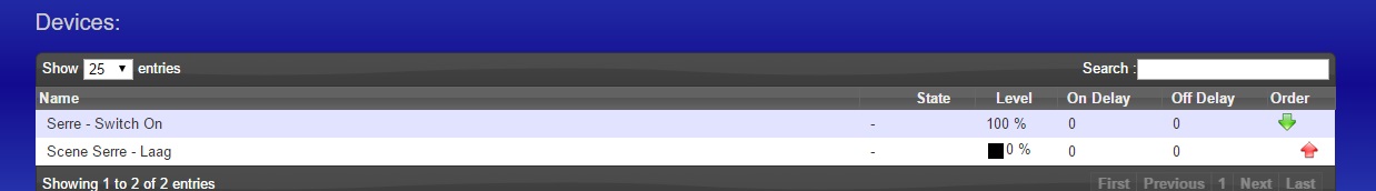

In domoticz i created a group in scenes an added two devices.
1. My fibaro FGS 212 switch
2. Hue light with a specified Scene low 25% from the HUE app.
When i used it from the domoticz dashboard no problem with on / off
When i used it from my puls switch in the wall i see it in the log i see ....Activating Scene/Group...... but the scene did'nt working.

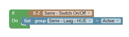

The following parameters are configured in blocky
Thanks.

try
If [[Serre - Switch On/Off] = On]]
Do [Set group [Serre - Laag - HUE] = [On]]
You should add a light which switches on @ the group @ If event because else it'll keep triggering.
So something like:
If [[Serre - Switch On/Off] = [On]] and [[Light from group] = [Off]]

It works thanks
