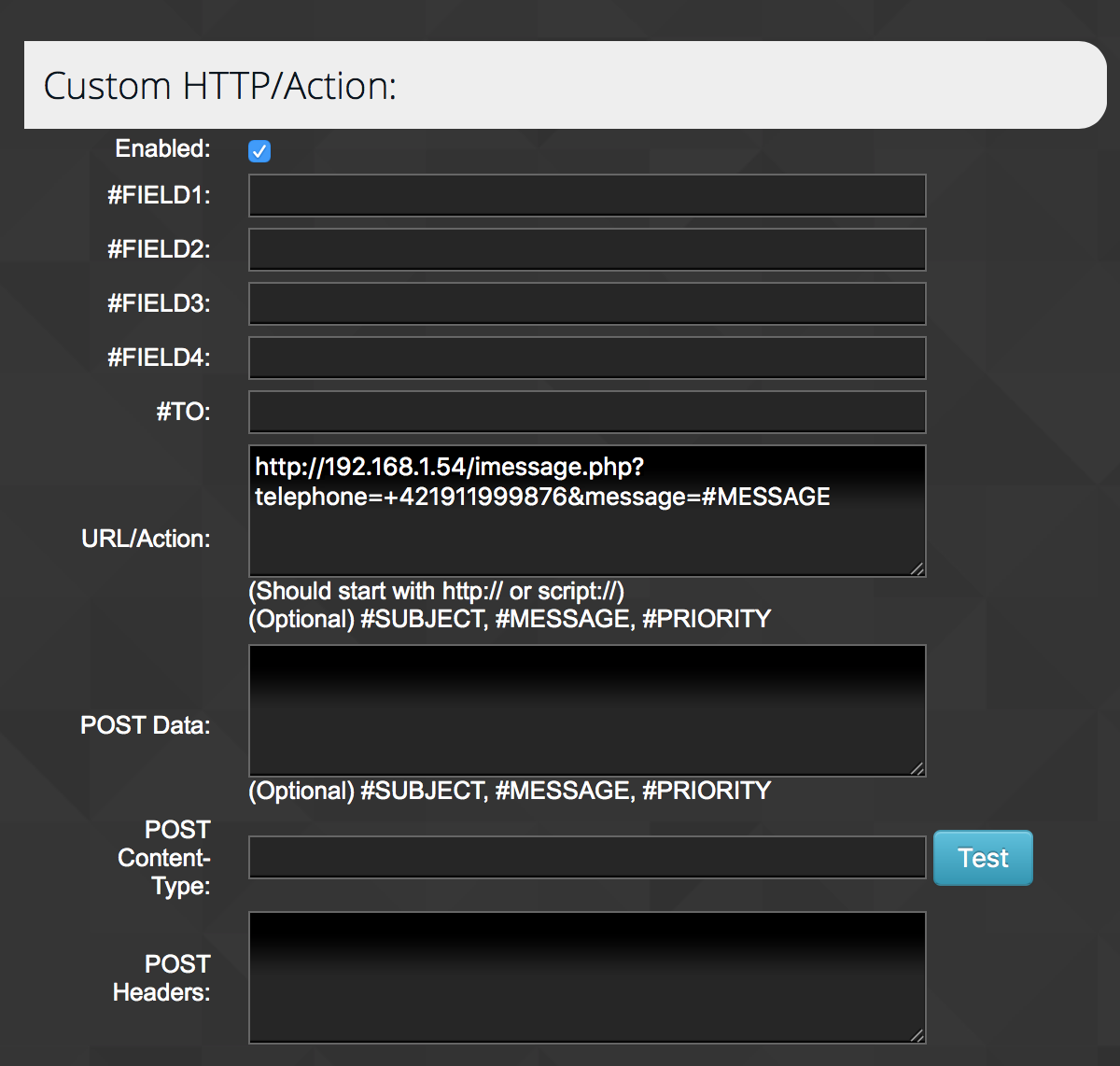

What is this?
You will be able to send notifications via iMessage trough your iPhone. There was a project before like this, but that project is needed a running Mac OS X computer. If you have an old iPhone around your house, then this solution is better. IMHO. :)
What do you need?
In Domoticz set Custom/HTTP Action:
URL:
http://192.168.1.54/imessage.php?telephone=+421911999876&message=#MESSAGE
That's all. ;)
