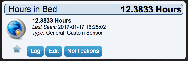

Create a "Custom Sensor" virtual sensor called "Hours in Bed" with Axis Label: "Hours", you can set your own icon if you like.
Go into events and create a new Lua event named "Hours in Bed" type of event is "Time"
Paste in the code, edit as needed and save. You can check the Domoticz "Status" log tab to see when it is activated, you will see printed something similar to this:
LUA: Added one minute to time in bed counter. Hours: 12.383333333399
There is good explanation of the logic in the code comments.

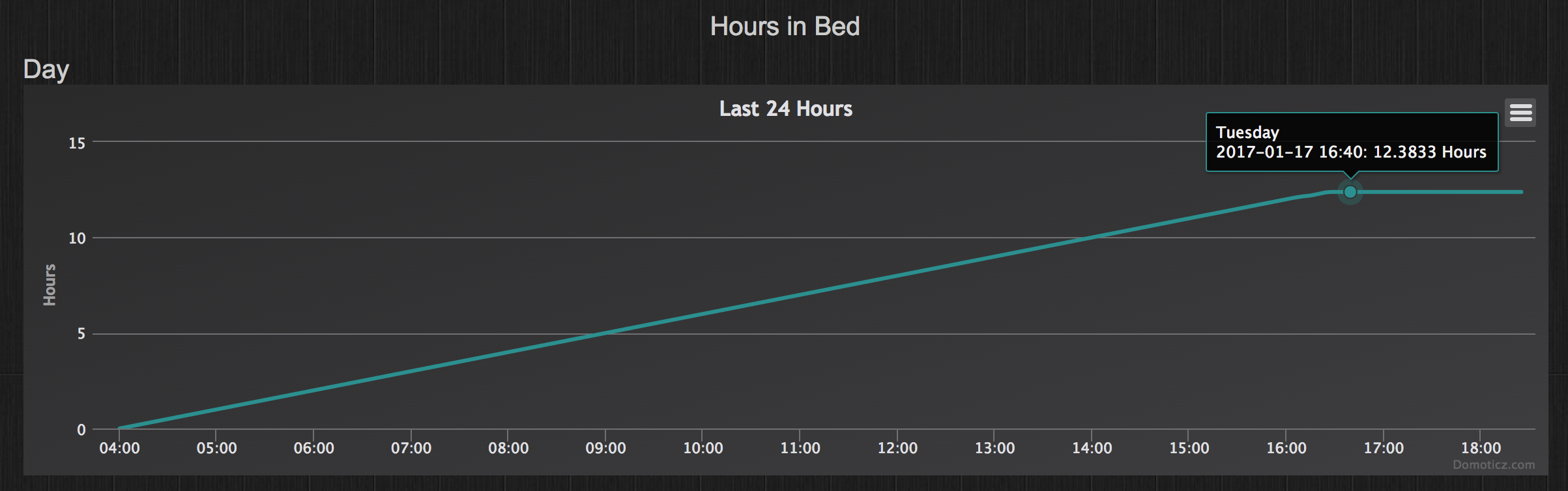

My favourite part is being able to check the Domoticz chart and see what times of day I spend in bed. :D

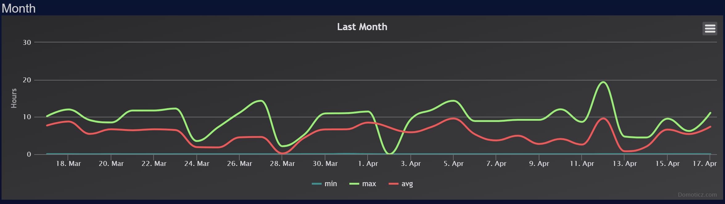

So far I am pretty happy with my time in bed counter, I've got over a year of stored data, here is the last month. :D
Hope this helps.
