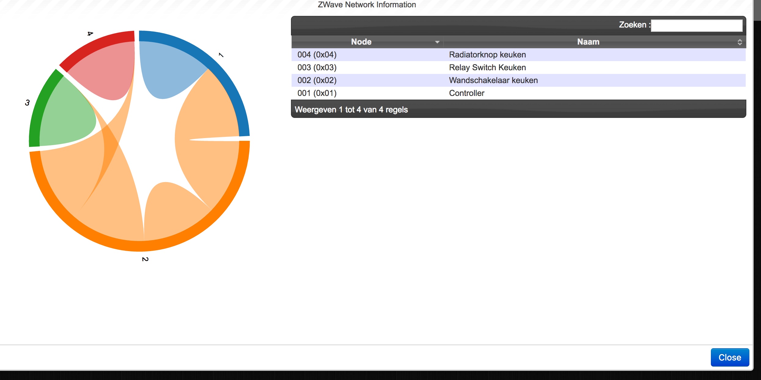

If you need help from the community, then make pictures of the current situation (hardware screen, Groeps & Network)

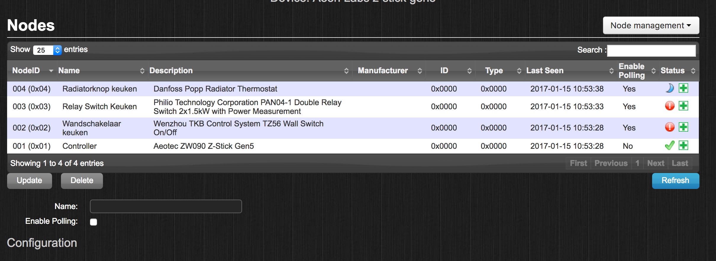

Thanks for the help. I have attached the pictures.

every node should have an ID and Type (pic: nodes.jpg)
At least the Controller and the PAN04.
The TZ36ZD is recognized as TZ56 and has a .xml file (and should be recognized also)
So something went wrong.
As result of that, you don't see any possibility to connect the controller (in Groups.jpeg)

Disable your Z-Wave controller
Remove the cache file: zwfg_0x.......xml in the Config directory
Enable your Z-Wave controller.
Check if you get the correct ID's (can be found in the manufacturer_specific.xml)
Success
